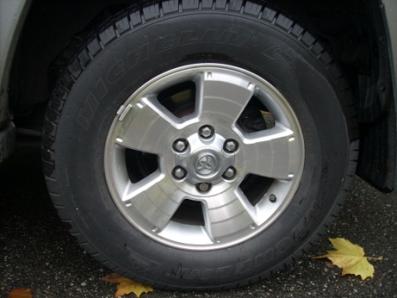

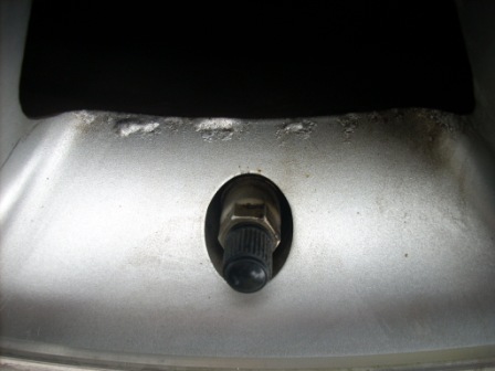

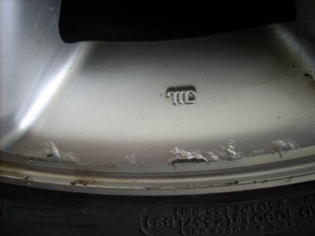

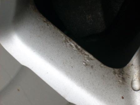

The service director says he can't do anything about it because I live near the beach and that's cause of the fog. I'm going to write to Toyota corporate and if that's their standing and how their product holds up to the elements only being two years old, then Consumer Report has gotten it wrong by placing them in fourth place. They should be much lower than that. The bottom of my 14 year old beater looks better the Tacoma.
Full wheel, no damage to it at from curb rash or harming the finish of the wheels.

Blisters

Spoke edge
