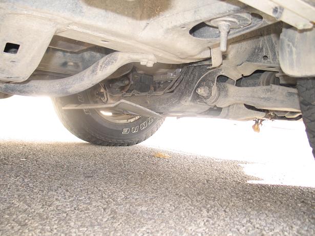

Last Friday night, when it was raining heavily, me & my wife was on our way going to a friend's party. The GPS lead us on a way which is kinda very rural and really, really dark. So dark that we weren't able to notice the sign "Water over Road"...as we we're travelling along the road, we didn't notice that we are about to approach the said water (mainly because the color is blending with the color of the road...). And then it happened so fast, the next thing we knew was we're submerged almost halfway in the water. Good thing I still have my presence of my mind and next thing I did is to immediately back-up the truck...fortunately, we we're able to take out ourselves on the said water but when we are already driving our way back out of the said road...a very screechy sound was coming below and it smelled like something was burning...We stopped on the first lightpost that we saw and checked what happened underneath our truck. And it was the metal plate just below the center of the driver and passenger seat. It was very very bent...so bent that it was hitting the road that produces the screechy sound and might be the one producing the smell too...when I actually looked at it, it made me curious as to what's its purpose??? why is that kind of plate placed there???
Anyways, I was able to bent back to its place and on the next day we had a long drive from CT to MA and back to CT again on the same day...everything seems to be fine with our truck...I hope!!!
I think the plate got bent because of the water current while I was backing up...maybe, I backed up so fast and the position of the said plate was so against the current thatmade it bent so much...

I haven't been able to determine exactly what that hanging plate is for!! Last time we were offroading, a fellow told me one of my skid plates was falling off!
i dont know baout the plate except for scaring the crap out of me after off roading a bit and seeing it when i got to my gf's house. needless to say the next day i was on all fours at the nearest yota dealership just making sure they all had it

Are you talking about this piece behind cross-member. I don't know if Toyota made it from metal on 2006, but my 2005 V6 Limited has it in plastic. It made to prevent blasting from road obstacles like small stones to transmission. But Toyota never thought that the truck can be backed-up while stuck off-roading or, as in your case, in high stream water. In those scenarios you just bend metal brackets which fix this plate to cross-member and engine skid plate. You can even rip it off. I was always worrying about it and lucky I didn't have a need to be recovered backward. Anyway, I think it has to go and be replaced with some aftermarket skid which will fully protect transmission. If you had an issue with this plate, don't worry, it can be bend back by hand or you can completely remove it.

I was "washing" my 4Runner in deep water one day. When accelerating backwards thru the water, my little plastic bit bent down. A quick bend and it is good as new. Not that new is all that good. Now I keep an eye on it to see when it needs to be repositioned.
