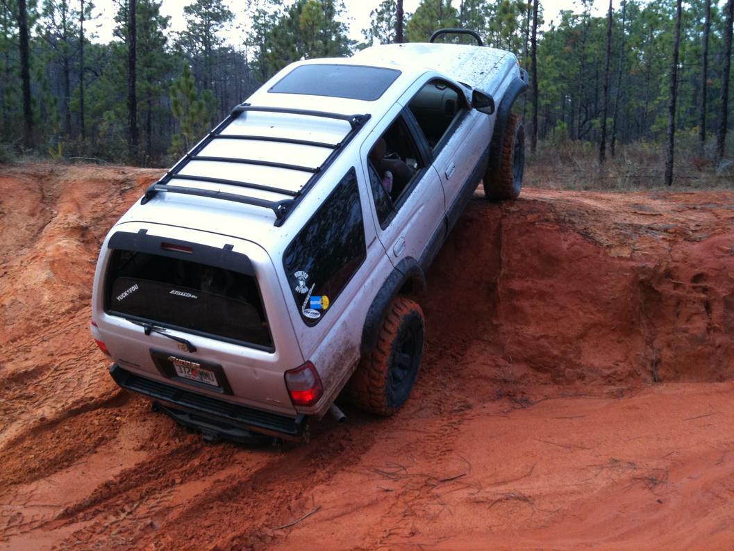

It'll all play out after the springs settle. See what it looks like after a week. I'm all for a little rake rather than sag. Plus if you do any climbing you'll notice that these 4Runners drag ass in steep climbs.
Wow! did this guy climb this with a tow bar? YES and it sucked
