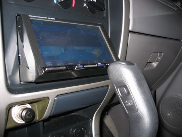

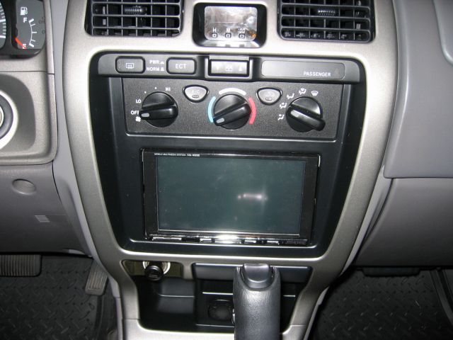

Here's pictures of the deck installed in an '02:
First, the view of the deck when in the off position.

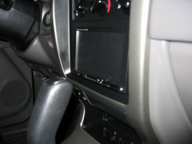

Finally, side view when off. When not in use, the deck automatically retracts to this position (it takes about 20 seconds for it to trigger once car is turned off).
Clearance with gear shift is not an issue. The deck tilts at 3 different angles. Even at its most extreme, there is at least an inch clearance when in Park.
Screen quality is very good. Only gripe I have is the glare when the sunroof is open.
