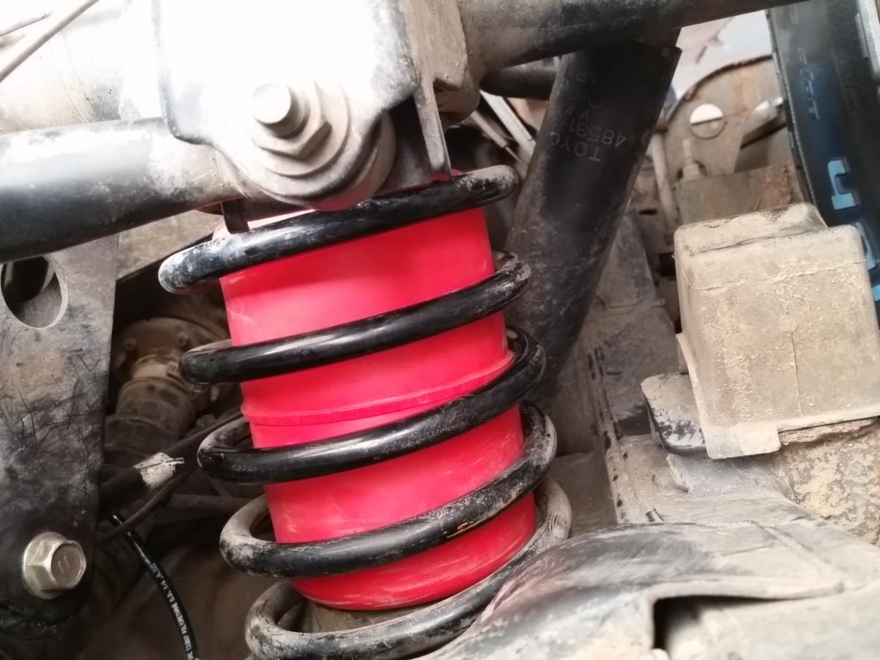

Just installed the airlift bags. Dropped it back down on the wheels and the axle is pushing against the airbag. Not good. Is yours like this?

Can you take a picture?
Mine's like this level with minimum 5psi in the bag
Looks like you've got the Timbren Torseq bump stops installed in there too! How does the combination work for you?
I ask, as I have an Air Lift kit installed in my 2006 Sport Edition and while towing my tent trailer on a recent trip, had one of the air bags blow, which then bottomed out my suspension. Am thinking about installing that kit as a backup should it ever happen again.
Cheers,
Jared
Nope, durobumps
