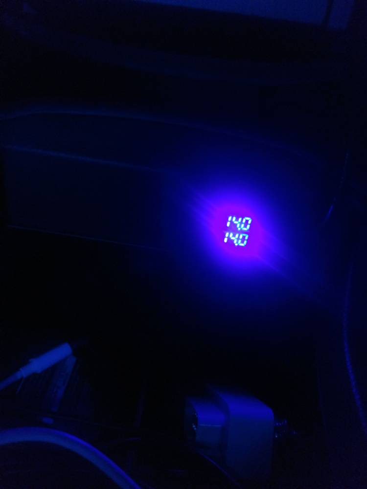

Colder this morning so the idle was up at 650rpm. I also have an alt-s diode but this should be plenty good at idle. I must have caught it warmed up with lights on yesterday to see it in the mid 12.x's

Nope, belt is still pretty tight. I'm convinced it's in the electrical system somewhere that's causing the ECU to change the RPMs.
At least you know your alternator is working. I'm still wondering if you can override the ECU with techstream and set a hard idle parameter.
Have you tried disabling the dual battery set up and going back to stock single battery to see if the dual set up is causing the idle/charging issue?
To a degree. I have a basic dual battery setup on a switch that lets me connect/isolate them. Whenever I reset my idle I keep them isolated and it typically idles correctly until connect the batteries for charging. I tend to run into the issue with the house battery has been drained down after sitting for awhile since I don't drive the 4runner daily.
