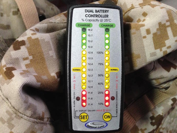

I've been running my dual optimas with National Luna Intelligent solenoid setup for a couple of weeks. The solenoid comes with a monitor and I'm able to see what the voltage on each battery is in real time.
I've noticed that once the solenoid is active (i.e. both batteries are receiving charge from the alternator) the voltage on the batteries is between 12.6 and 13.0 when idling at 700 RPMs. Is this too low?
While driving I'm seeing the charge on both batteries get up to around 13.5, but I'm worried that prolonged idling where, no real charging is actually happening, is going to have an adverse affect on the longevity of my batteries. Are these concerns unfounded?
EDIT: Whether it's bad for the batteries or not, isn't this a bit weak on my alternator's part? The Life Remotely guys, who did a similar 4Runner Dual Battery install, apparently were able to charge their setup 100% while idling in under an hour. At my rate, it may not charge at all.

Yup, I have already verified the meter's values with a voltmeter. Every time I've spot checked it it has been right on. I believe the data can be trusted.
What do you mean by at rest? These are the idling values in normal usage, though I did have my stereo and small amplifier powered on when taking this picture.

I have the same controller, except that the 2nd batt is in the National Luna "Portable Power Pack" so it can switch between vehicles.
Mine reads at 12.6(100%) with the batteries separated, engine off after sitting overnight.
With the engine warmed up and idling at 700/800 RPM, and the batts connected, it reads at either 13.7 or 14.2(the two highest indicator dots).
