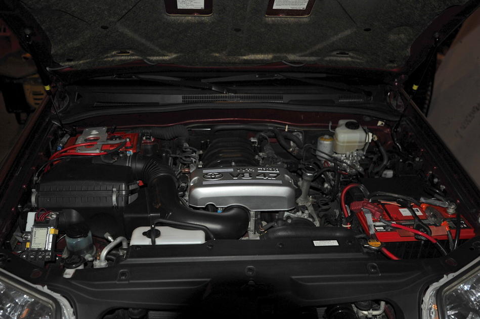

.. I'm not sure if a batery that large will fit in a 4th gen ...
I've got the Odessy 2150 in the stock location and it fits nicely
