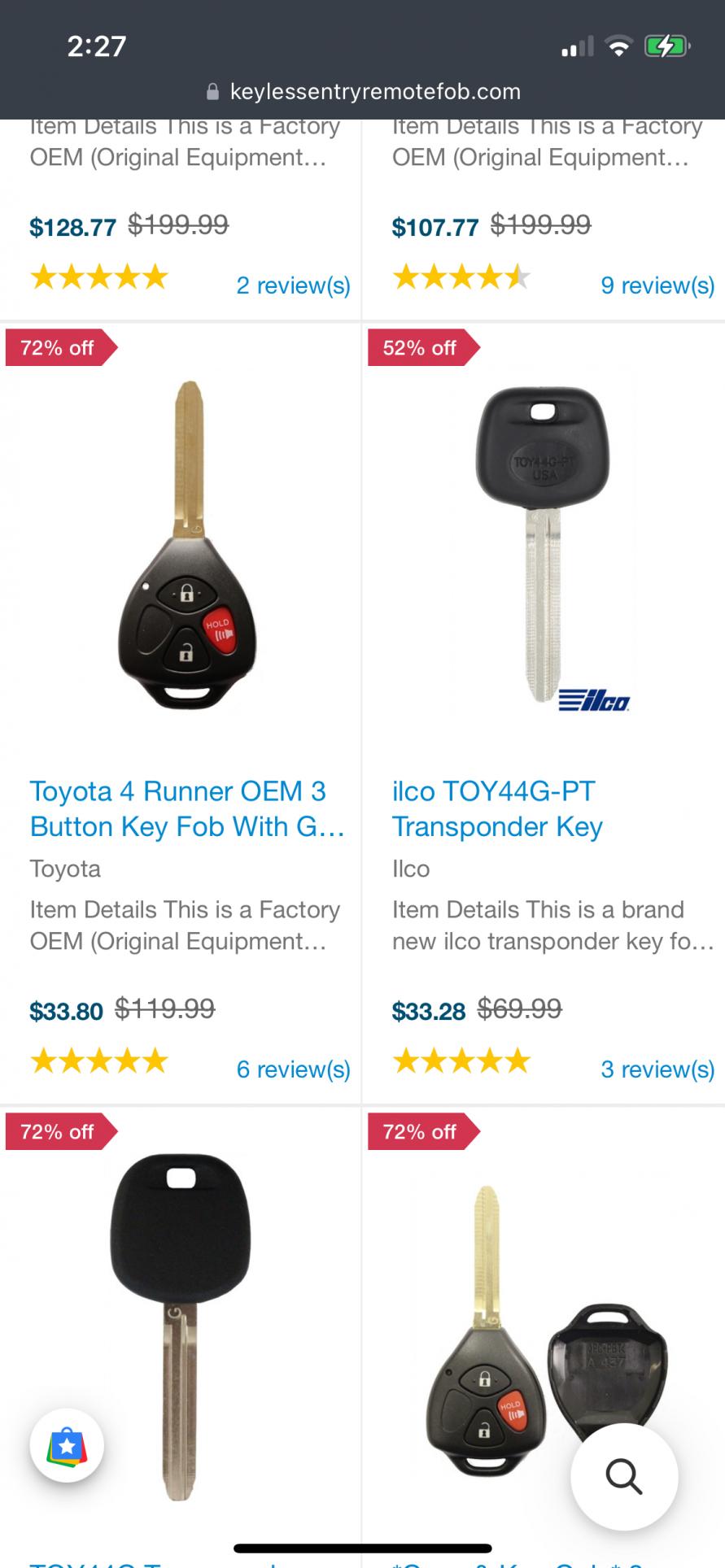

If you want to buy on line I saved this screen shot. I do not have any reviews to offer, so if you do use them please post your experience.
