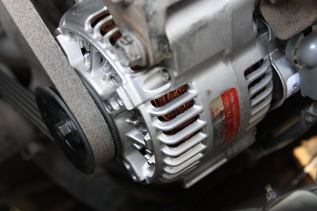

If I was doing it again (not needing the bigger alt specifically) I would simply do what rickashay did...
After some power issues on the Whipsaw trail, it was time to replace the alternator. While I was at it, I did the battery. It didnt hurt that I got my battery for dealer cost!
Re-manufactured Toyota alternator. After thinking about doing the Chevy CS-144 Alternator, I decided to stay Toyota seeing as how the original lasted 13 years. I got my friend at the Toyota parts desk to look for something that puts out more than the standard 98 4Runner alternator's 60A at idle. The 99 4runners apparently came with one that puts out 80A at idle, so I ordered one of those.
20110727-IMG_9899 by RickaShay24, on Flickr

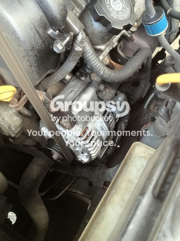

I think I will keep it simple and grab a remanufactured 80A alternator from Advance. $125 w/ $30 off $100, or $50 off $150.
I wish this thing quit on me last week when I had time to work on it. Hopefully the reman replacement will drop right in with no issues.
Probably a good choice. Reman alternators are usually a pretty solid bet...not a super complicated part to remanufacture.
Just snagged the 80A "Wolrdwide" alternator from Advance with a $50 off $150 coupon to bring the price down to ~$84 plus tax.
Can't complain.
I'll let you know how she drops in. Only a $25 core, so I may take it apart and see what the brushes look like. Might be able to flip the repaired alternator for a few bucks if that is all it needs. Has anyone successfully repaired an alternator doing just the brushes?

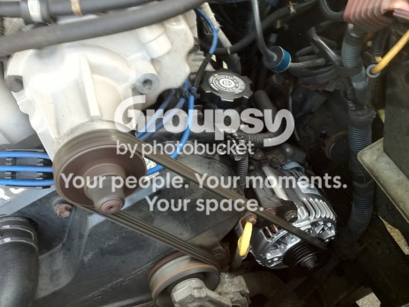

In case anyone is interested, the remanufactured alternator at Advance Auto, the "Worldwide" is a remanufactured Denso and it looks practically brand new. As expected the alternator dropped right in with no issues whatsoever. Fortunately for me I had no corrosion issues to deal with. Since I have an automatic belt tensioner for the supercharger, this was as brainless of an installation as you could imagine. I left the adjuster as it was and that was that.
I can certainly recommend the generic replacement from Advance. Especially for ~$85.
