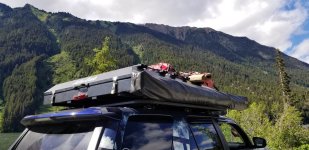

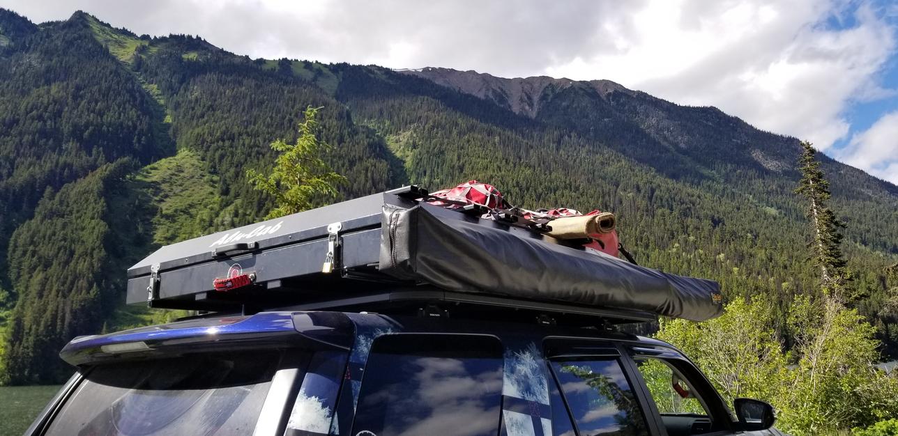

Just adding as a future research option. Trussed up the Rhino rack Awning brackets and right to side of tent with the Shadow-Awn. It is workable for us as is but may move it higher if an issue as we use it.

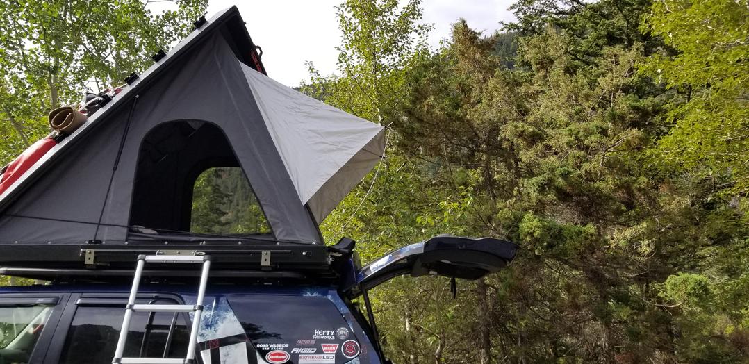

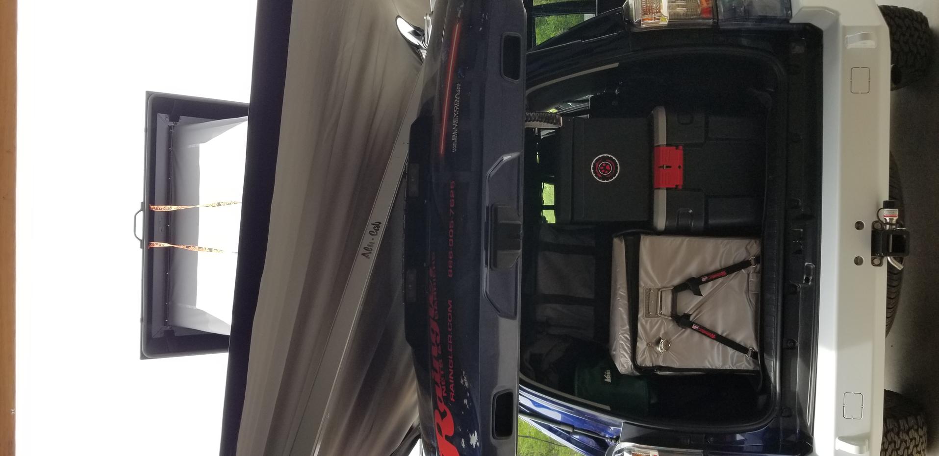

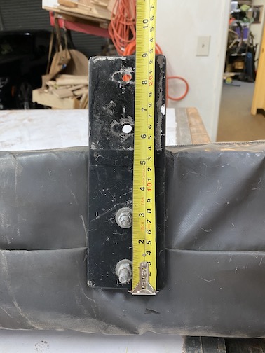

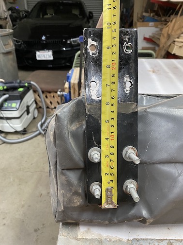

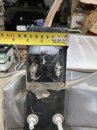

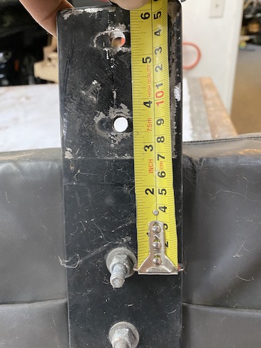

Just finished making and mounting the risers. They work perfectly. happy to share specs and a few obstacles encountered to watch for if interested. Now there's no interference at all. In fact, the awning deploys exactly above the open lift gate.
[MENTION=135875]alirawk[/MENTION] - I'm looking to accomplish the same - Alu Cab Shadow Awning mounted high enough to open rear hatch - could you share those specs you offered and any other notes on obstacles you encountered please? My concern is the weight/leverage that it will put on the mounts by attaching to the tent. Any info would be much appreciated. Thanks!
Sorry for slow response.

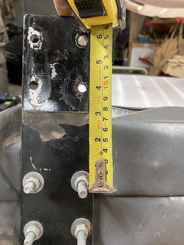

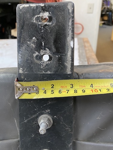

Luckily I have the awning off the ride right now so it was easy to take measurement and pictures. Here they are.
The pictures show the length and width of both brackets -- but more importantly the gap between the two sets of holes. I used 3/8" stainless steel. Surely overkill. You could certainly use aluminum to save weight -- but clearly that's not a concern for me at all. But aluminum would be easier to drill through -- I have a drill press so it wasn't an issue for me.
To get a little added height without adding length to the bracket -- you can take apart the awning hinge and switch around the order of the arms.
The whole process was a bit of a pain, but mostly because I was figuring out largely on my own. I'm available to talk on phone if you have any questions.
