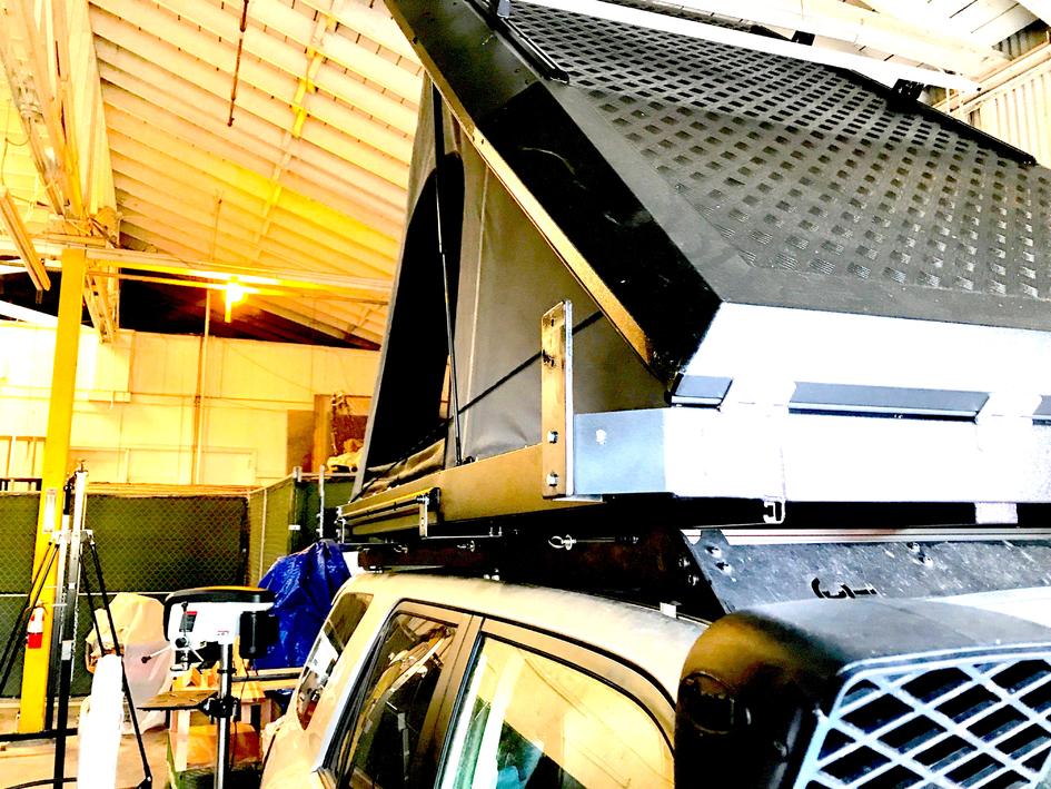

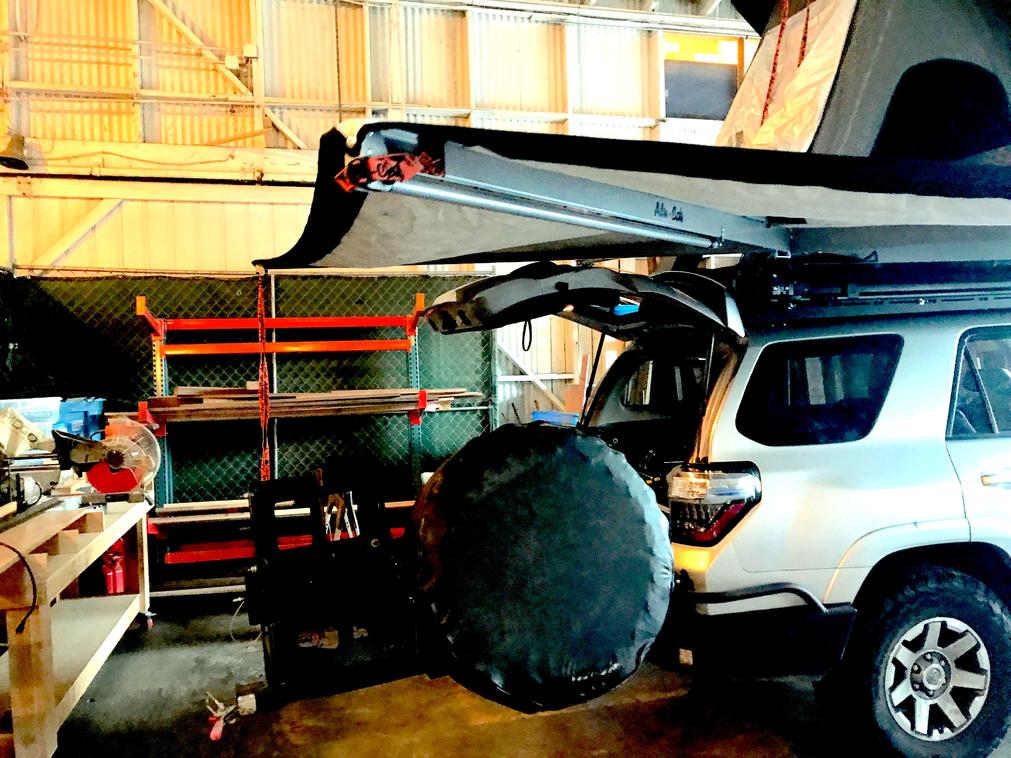

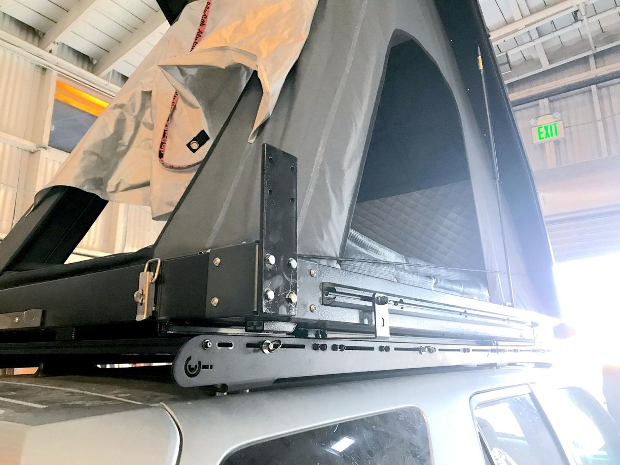

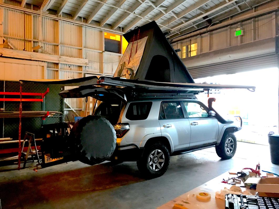

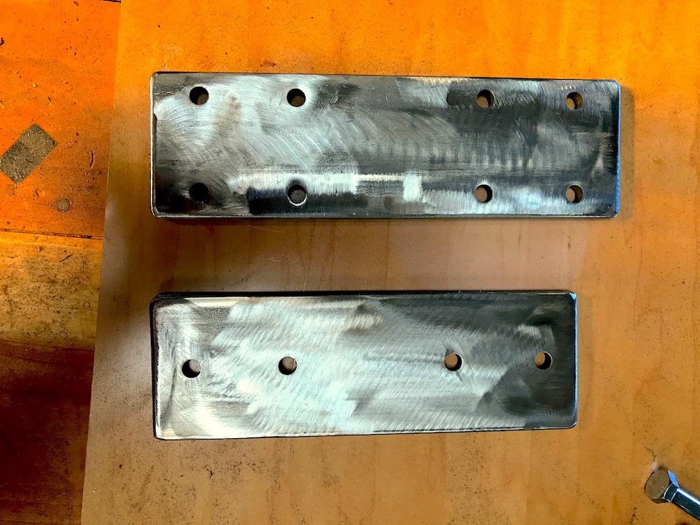

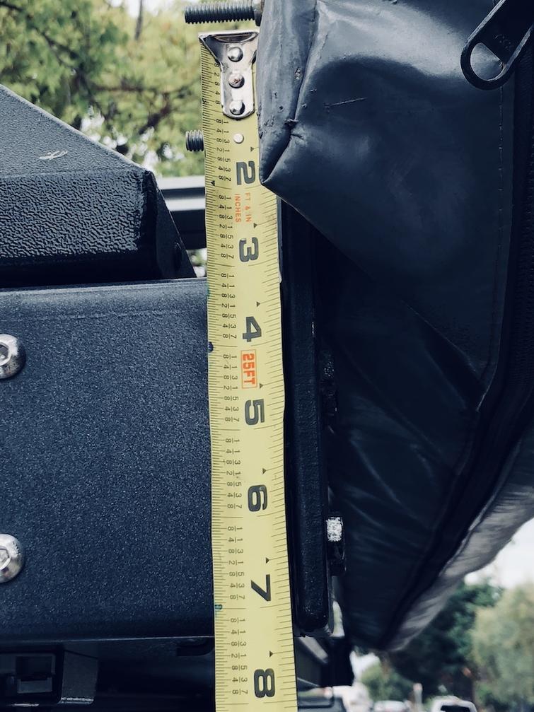

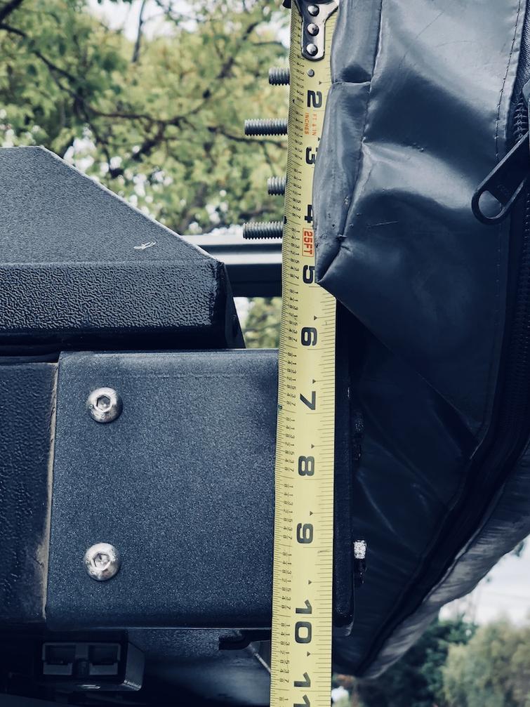

Just finished making and mounting these brackets. They work perfectly. The awning now opens almost exactly above the opening of the rear lift gate. Perfect.

Doing the exact same install this week. Thanks for the riser brackets idea. Looks pretty beefy (1/2"?) plate? Didn't happen to have dimensions or pattern that worked out by chance?

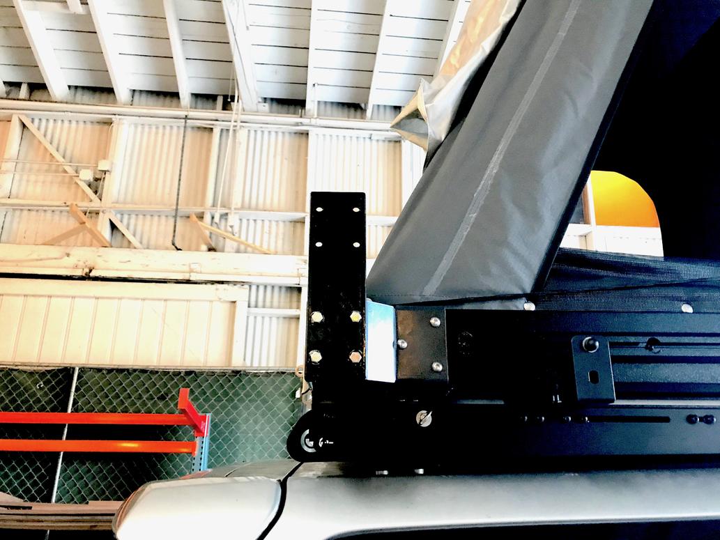

The pattern is really simple. I used 3/8" thick stainless steel. 10" high by 3" wide. Used a grinder to give a round to the sharp edges. Then painted them black with rustoleum.
For the bolt pattern, I simply used the brackets to trace the bolt pattern on the bottom of the steel extension piece and again on the top. There should be a 4" gap between the bolt patterns, which is about all the additional height you need.
Here are a couple pics for reference. Let me know if you need any more help/insights.
