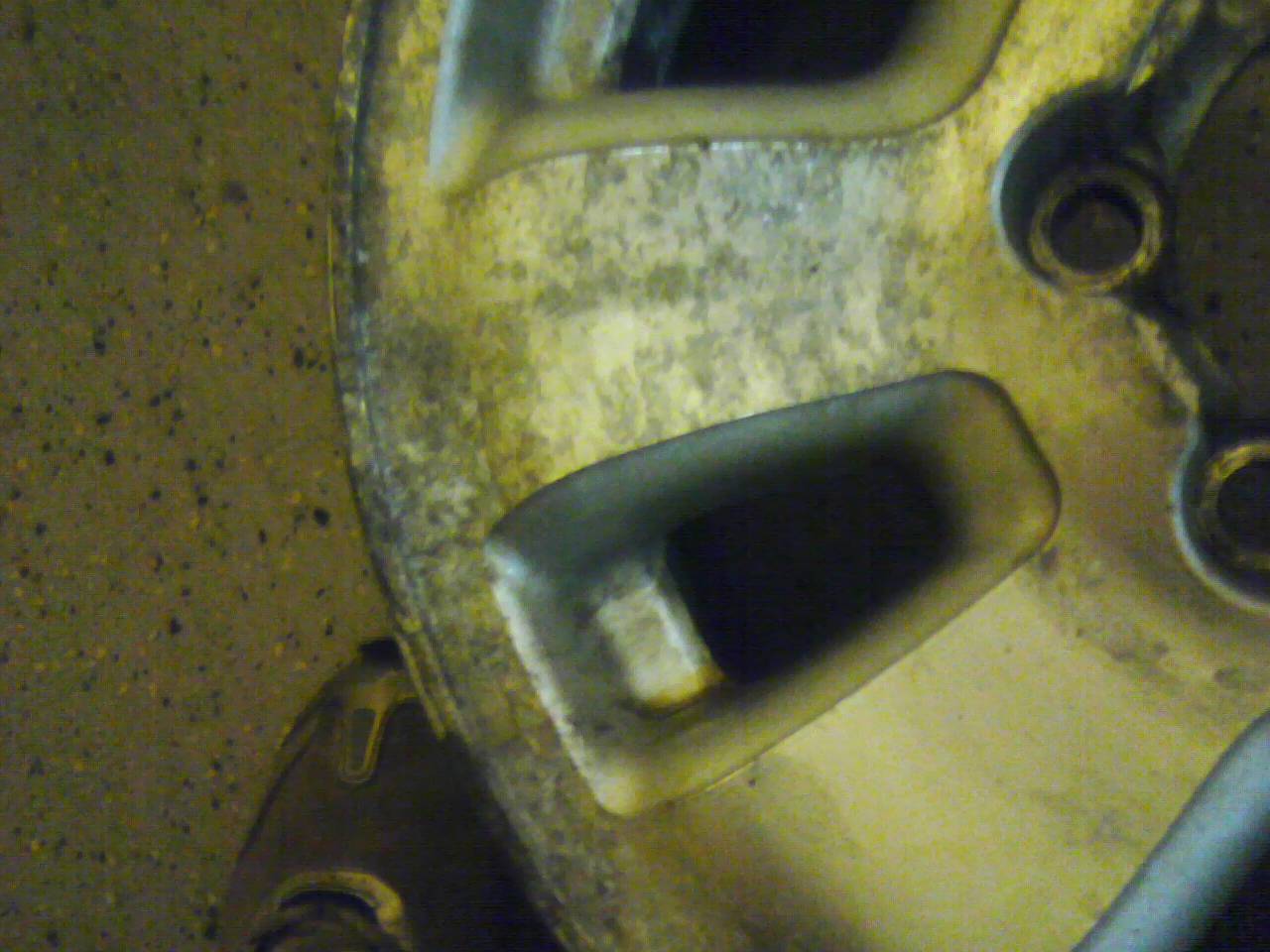

Alum wheel corrosion.

heres how bad mine are, sorry crappy cell pic.
Good news is i installed a better set of these today. Wa Hoo
