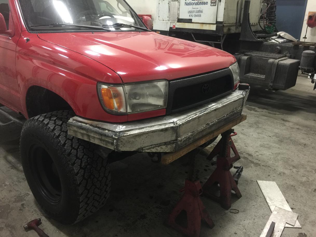

If anyone knows where to get some aluminum D-Ring mounts please let me know... Haven't posted in a while and I spend some time looking online for them and all I can come up with is the ones you mount inside a hitch. I'm in the process of making an aluminum front bumper... Or if someone can get me dimensions of their steel ones that weld on I would appreciate it. Thank you

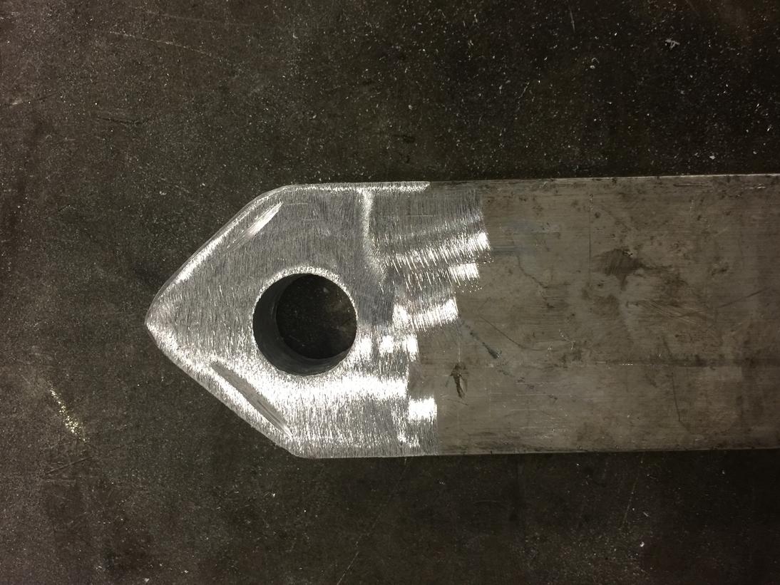

My steel ones are 5x2x1 but I got those dimensions so I could go through a 2" tube rear bumper and weld both sides. Center of the hole is about 1.1" in from the end. Hope that helps.
Started making my own... Need to shape a little more... Will be welded on both sides of bumper and will be used as mounts to the frame.
