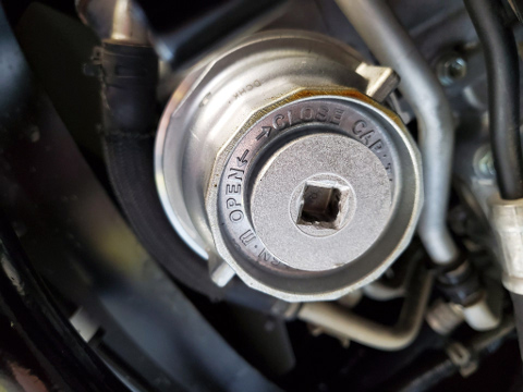

2018 4R SR5 at 30k miles.
Last oil change I replaced the original plastic oil filter cap with a TOYOTA aluminum oil filter cap bought from Amazon and advertised as Toyota genuine part 15620-31060.
Replaced the inner cylinder with the one from the original oil filter cap, bent the tabs back out, etc.
New gaskets, oiled before install, everything torqued to specs, I noticed the cap screwed in very easy all the way to the end. The plastic cap was getting really hard to screw in about half the way, and had to use the filter cap key to be able to screw it all the way in and torque it correctly. Didn’t think anything of it, torqued the aluminum cap to spec (even though it was kind of bottomed out), and away I go.

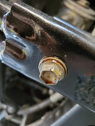

I kept on eye whether there is any oil leaks and after about 350 miles I noticed a light glinting below the oil cap. I dropped the engine skid plate and found that indeed this thing is seeping oil.
I ordered another identical part from Amazon to test, see if maybe I got a bad part …. Will get it tomorrow.
Anybody experienced this ?
Thoughts ? Advice ?

Just to check..you are using the second o-ring under the bottom cap, right? I have the aluminum Toyota housing and dont have leaks after three oil changes.
I have both o-rings in place, yes.
To me it looks l ike the leak is from the top and flows down the wall. Doesn't seem to originate from the bottom cap.

I have being using mine for years without issues. Since it is original part, you should have OEM fit. Make sure you place big O-ring in proper channel and rub some oil on it so it doesnt deform inside of receiver when you tighten the assembly. G.L.
Is it possible that you accidentally cross threaded it on when you put the aluminum one on? They don't seem that easy to cross thread to me. If not, maybe you have a faulty cap assembly (manufacture defect)?

Today I removed the engine skid plate with the intention to replace the aluminum cap with the original one. I expected to see more oil leaks, but the thing was dry as a bone in the desert. No sign of oil leak anywhere !!
So I am going to leave it on for this oil change cycle see how it does. Maybe it's going the turn out to be a keeper.
I had this same issue and discovered it was just the oil from the threads itself running down. Stopped leaking once that little bit drained out entirely.

There have been other threads concerning this issue. If installed properly the metal housing snugs right up, bottoms out, and cannot be torqued any tighter like you experience with the plastic one.
If the o-ring is installed properly any leaking is due to a small amount of oil on the engine side threads seeping out. Once it all seeps out it’s done.
I saw that leaking with mine the first time after installing the metal housing. Now I clean all threads well and leave the skid plate off for a day or two of driving to check it. I’ve never seen any more leaks.
