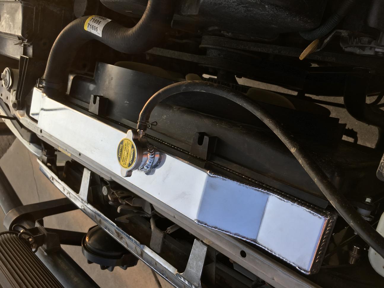

I just installed one of these in my 4Runner. I'd post pics, but Photobucket is lame.
Aluminum Radiator
It's a 3 row radiator and it's significantly thicker than stock. Took slight modification to make fit. I had to oval out the mounting holes in the core support. Fan shroud bolts on fine.
I have a scan gauge that I display water temp on constantly. Since install I haven't seen the temp go above 190. Thermostat opens at 180(edit).
It's the Champion one (CC1998) that SURF RUNNER mentioned above.

You mean this champion? Just google cc1998 radiator
Aluminum Radiator
I have a scan gauge that I display water temp on constantly. Since install I haven't seen the temp go above 190. Thermostat opens at 188.

So what were the coolant temps before installing the aluminum radiator?
Nothing crazy. Average probably around 190-193. Maybe probably up to 195-196 a couple times. I've had the aluminum one installed for about a month and with the July heat in NC I've been impressed that I haven't seen it over 190 at all. It is much larger and takes quite a bit of coolant, so it makes sense.
Very nice:thumb: The fan shroud encompasses the fan more now as well, helping to push more air across the radiator.
