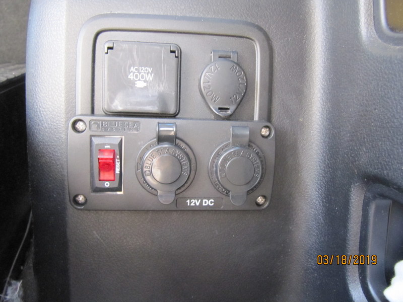

If You already have 12 volts in the cargo area you can install one of these.
With the switch to turn it on when you are charging a devise and off when not.

Where can I get one like this and how did you wire it?
I got this from Amazon.
Go to my Album page I have a pictorial write up on this including how I ran the wire and what size. I also installed a Sub fuse panel in the wheel well. I show that also.
Keep in mind I have a dual Battery system that feeds a main relay and fuse panel under the hood. This feeds that sub panel in the wheel well.
The larger wire running from the engine compartment to the rear wheel well is fused at the main panel.
The sub panel has fuses that will protect the smaller branch wires to the plugs and protect the device plugged into it.
You don't need a dual battery system to install this but make sure you fuse the feed cable at or near the battery to protect the cable.
Then fuse the blue sea device at there location. I think the device comes with a inline fuse holder at the device.
This sound like over kill, but You need to isolated your electrical Mods from the OEM system as much as possible.
