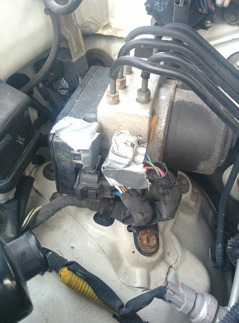

To disable the ABS I pulled the top connector off on the ABS actuator.
To disable the ABS warning light I put a piece of tape over it.
That's one good bulb - it's been on for 6 years.
