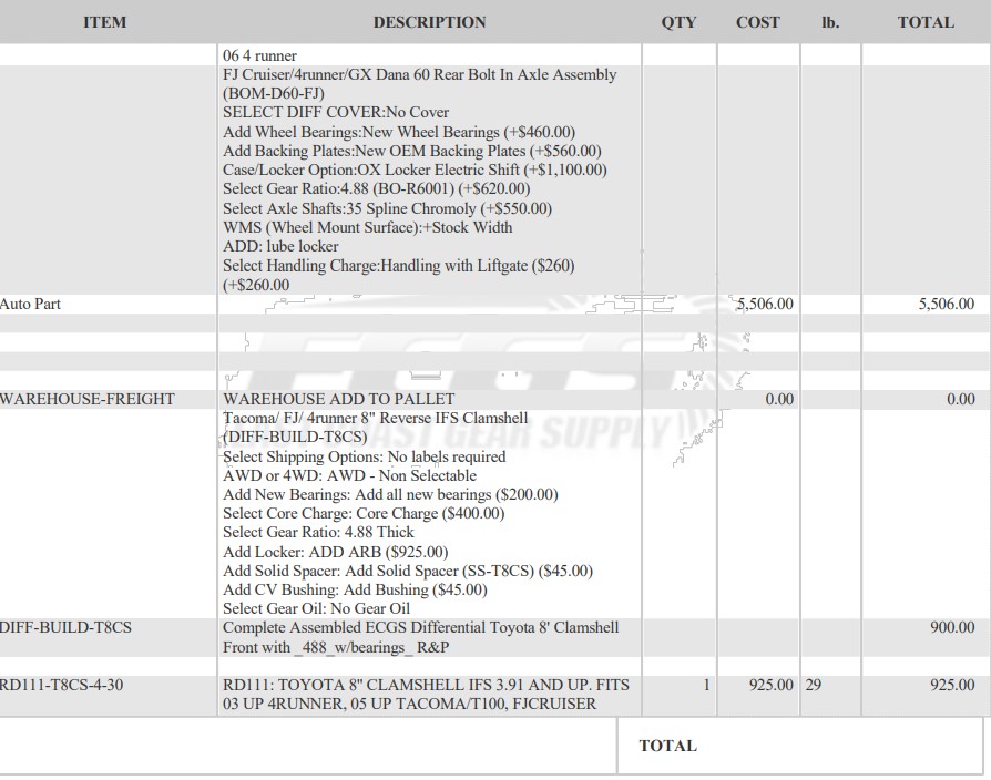

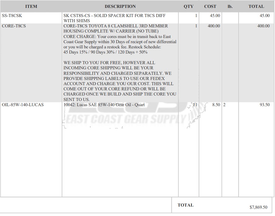

Am i going overboard on Re-gearing and Dana 60 axles?
So with the Dana 60, 35 spline chromoly axle shafts, electric OX rear Locker, 4.88 gears, ARB front locker and EVENTUALLY the Marlin Crawler kit, I should be beefed up a bit compared to rinky dink OEM crap.

Hey bud, thanks to you, I finally ordered my Dana60, regear and lockers!

Can't wait! Should be here around June and installed. After that, the grueling breakin in process lol. Can't wait for lockers and some extra added beef to the rear end! The Ox locker should be nice with the front ARB locker.
