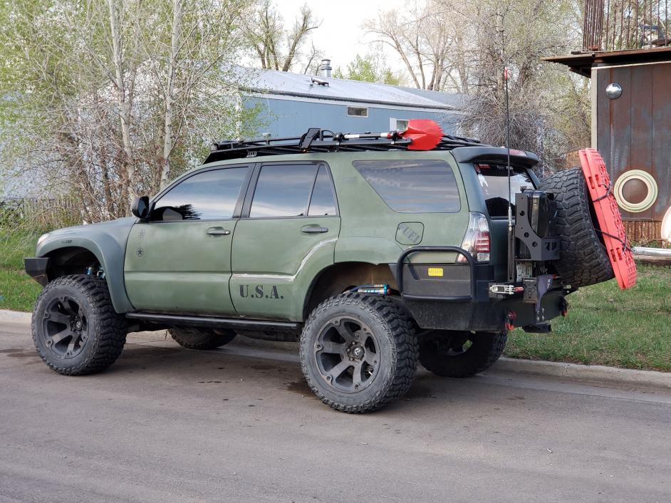

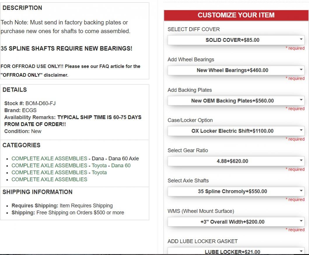

So I have a 2006 v8 4runner with a loaded weight of around 6200lbs. Looking to regear the differentials to Nitro 4.88 and installing a dana60 axle with 35 spline chromoly axle shafts, and Electric OX Locker. I'm just cruising around the back roads of Colorado and eventually want to tackle Moab without having to worry about breaking axles. I've included the options from East Coast Gear Supply of what I want.
Also the front diff will have 4.88 gearing with ARB air locker with RCV axles.
I want to be LOCKED AND LOADED!

What about a Diamond 9.5 axle? Any reason to chose one or the other? They seem pretty much the same as far as beefy-ness goes. Looks like the with the Diamond, I can fit 32 spline rear axle shaft compared to a 35 spline rear axle shaft on the dana 60.
Same, either Marlin or the JD Fab parts, there's a Tacomaworld thread on them, cool stuff. Haven't checked on the Marlin stuff recently.
With the rear axle, if you can stuff your tires up inside the wheel wells (I did it with 12.5" tires) it makes sense to stay stock width. With the wider 37's I figured I wouldn't even try, and now it matches the front long travel width. That and the tires and wheels act like a slider now on some of the real hard obstacles to push your body away from rocks or trees. Of course though the tires and wheels get scraped up more. Just my 2 cents.
I'll have to check on JD fab and see what I find.
I thought the Diamond uses stock sized axle shafts which are 30 spline. If they do use stock sized axles then IMO they aren't much or any stronger than the 8.2 axle as I've heard rumor of a couple of those breaking axle shafts and not the gears.
I was talking with Just Differentials and the guy said these 32 spline axle shafts will work:
Nitro Pro Series Chromoly 32 spline Upgrade Axle Kit
My brother waited over a year for a full float Diamond rear axle to be built with the 32 spline Landcruiser axle shafts but they never got past the R&D phase even with multiple people's deposits. As far as I know they still haven't finished that full float project.
On the Nitro 32 spline axle product page it states "full float only" but I'll admit I don't know enough about the details to know if its possible to use on a semi float or if they did finish that full float project that has the special sauce of using the factory wheel speed sensors.
