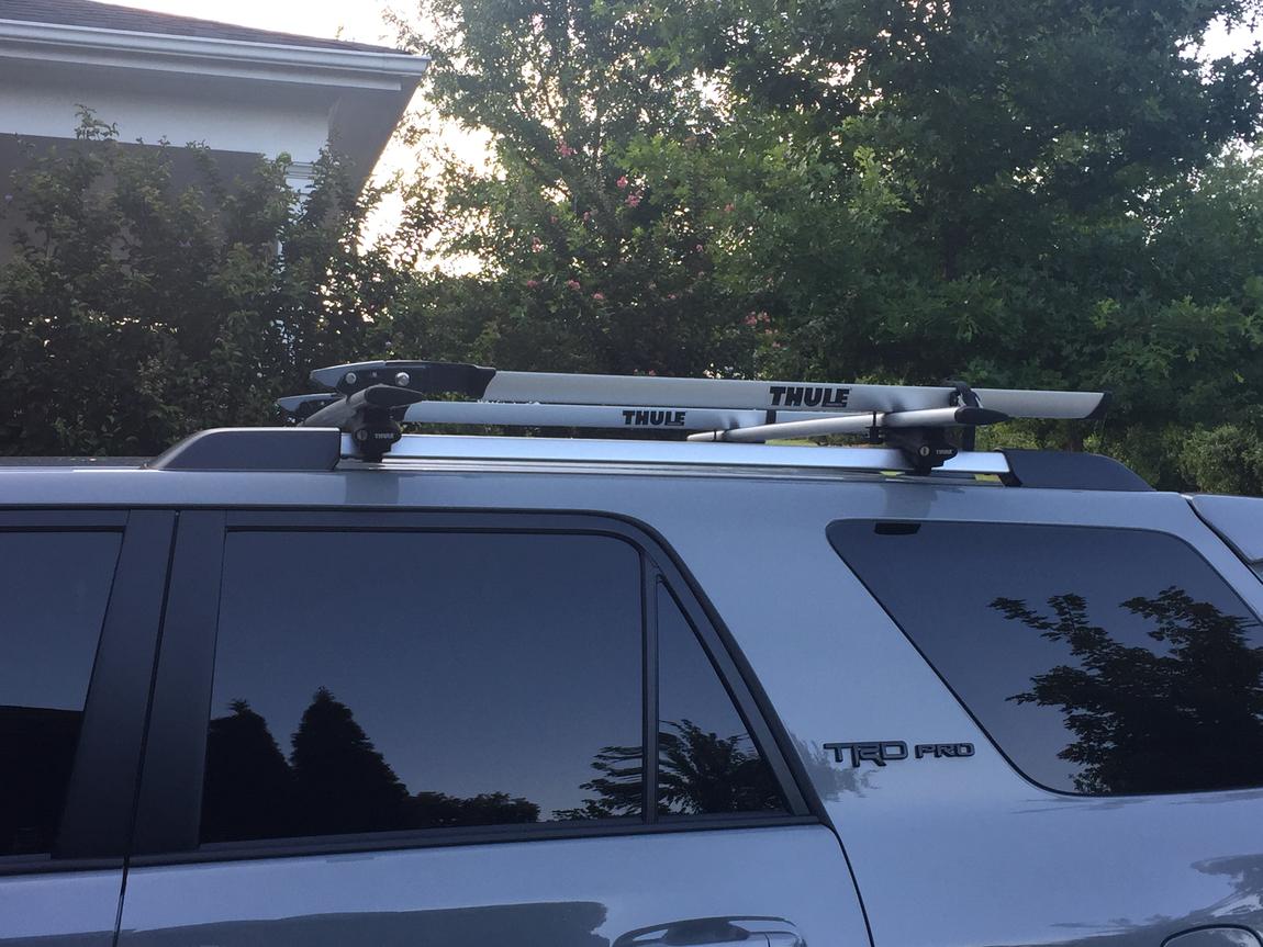

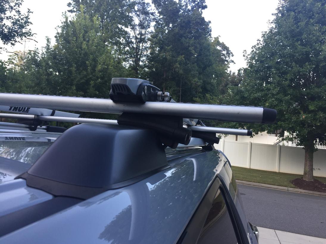

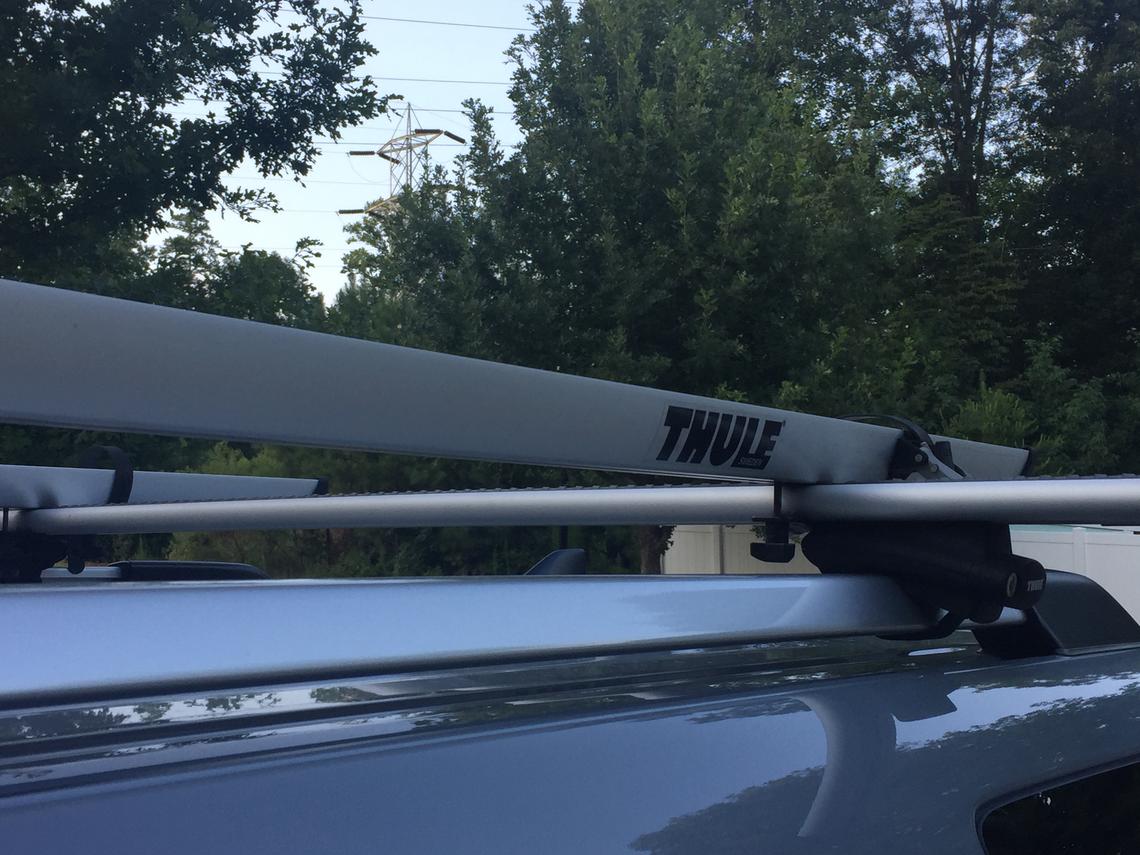

I measured and my bars are 60". I'm sure 53" would work well and probably look better but I already had these. Here are a few pics where you can see the bar width and height difference over factory crossbars.

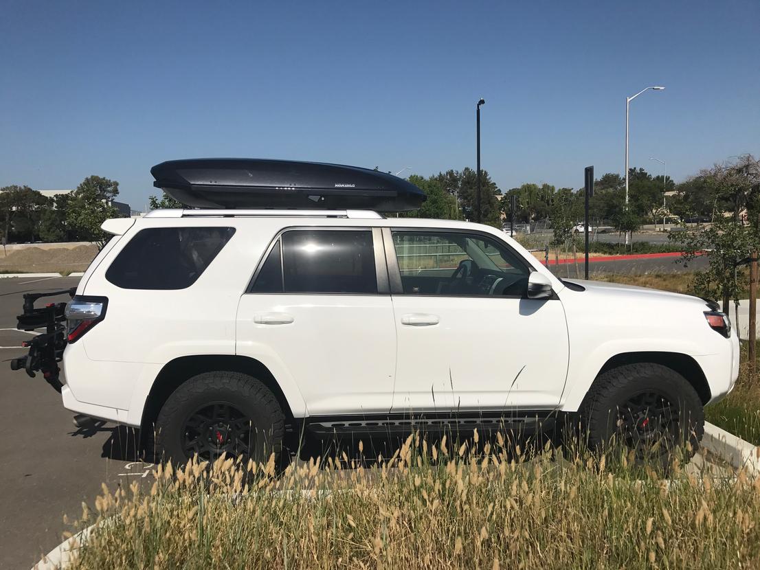

I would suggest going with the yakima showcase cargo box. It fits the stock roof rack perfectly, no issues at all and rear hatch still have plenty of space.
