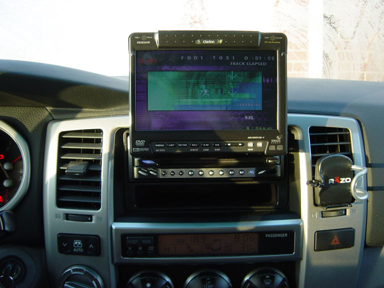

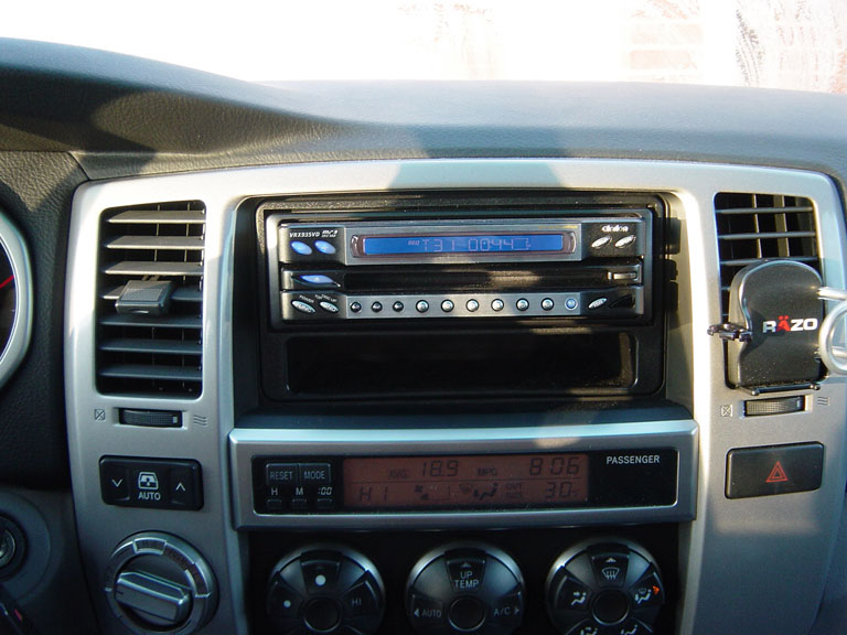

I installed the american international TOY-K975 kit and it fits perfectly in my sport edition. I'll snap some pics when I get a chance.
It fits in my Sport. Here's a pic of the Clarion VRX935VD using the American International installation kit that the AI tech told me doesn't fit in the Sport or Limited Edition.
