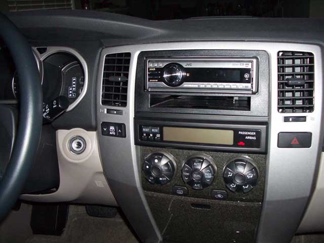

Just an update: I got a chance to work on my truck this weekend. I pulled apart the cargo area (thanks to Mr. Castulucci's instructions) and unplugged the harnesses that go to the amp. This did the trick. I hooked up my new headunit (JVC KD-DV5100) and it sounds great. Now, I am working on getting the PAC SWI-X to work for the steering wheel controls, I'll start a new thread on that.
Here's a picture of the finished install.

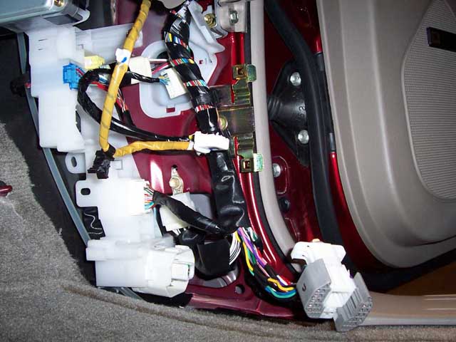

Here's where I tapped into the speaker wires, behind connector IO2 that is in the passenger side kick panel. It was fairly easy to do and I didn't have to run new wires all the way from the amp in the cargo area.
