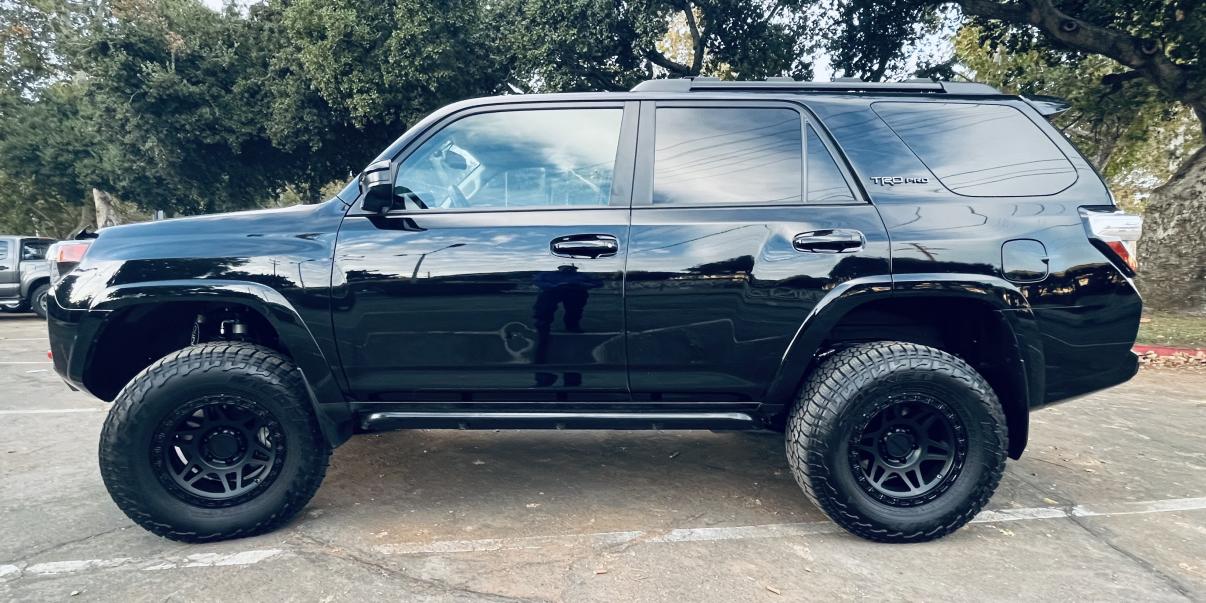

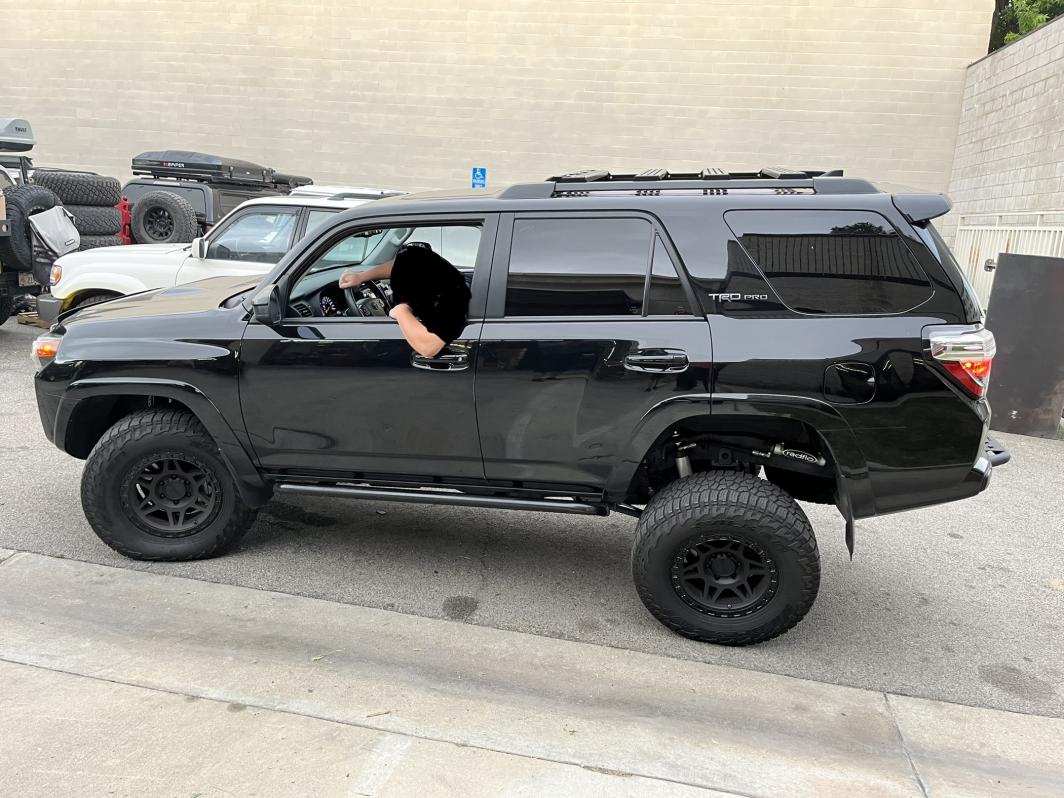

Well in my case I’ll take the high five. On my 2018 Pro I run a 285/70-17 on Method 17x8.5x0mm offset wheels and did not do a BMC and still have my OEM mudflaps. Just pushed the front liners forward a bit. The front lower fenders on the Pro are already trimmed. Running 3.7 degrees caster and with a static forklift test had no interference at all. 4wheeling off road I have some minor scuffing when articulated and bouncing.
