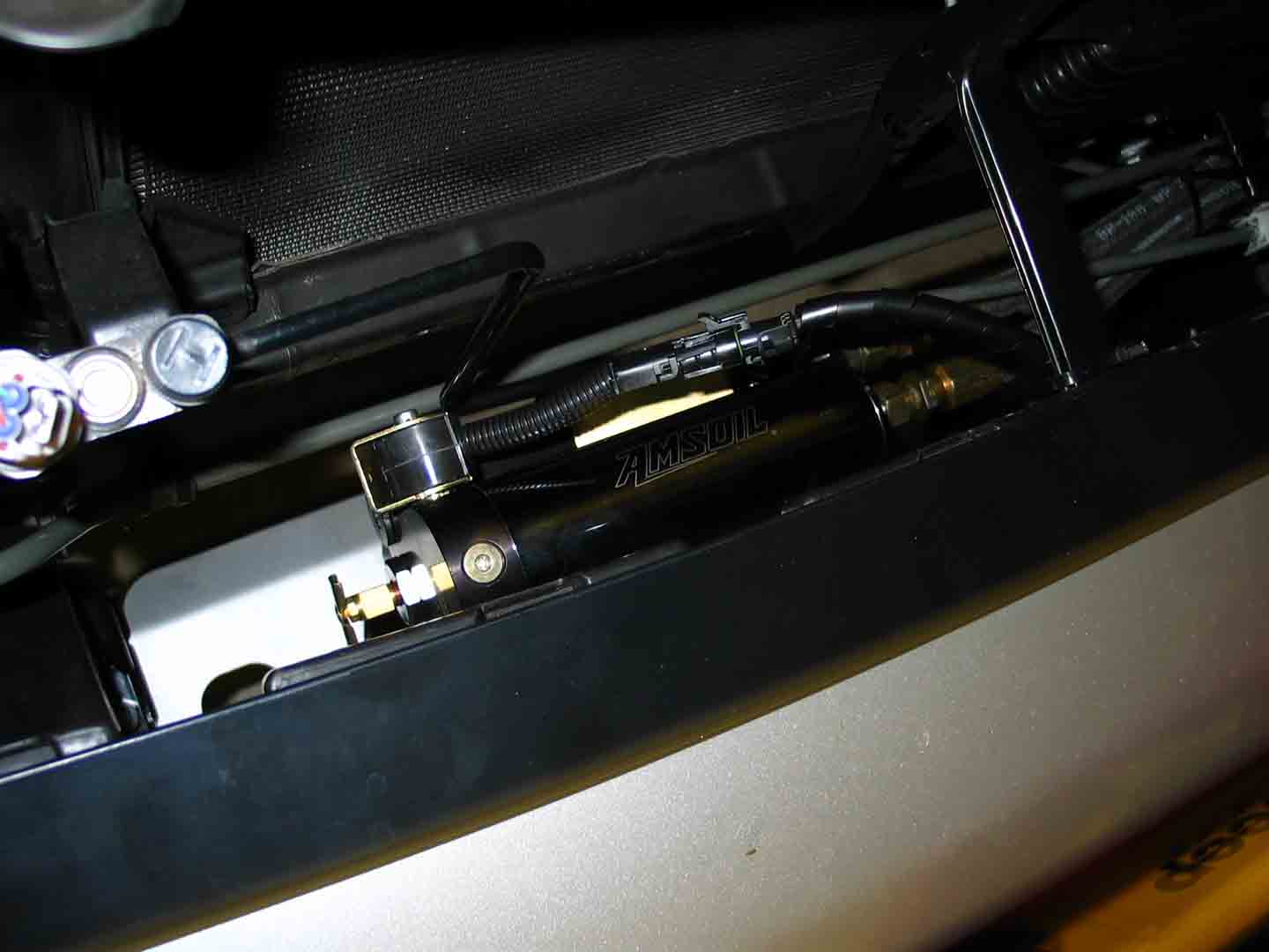

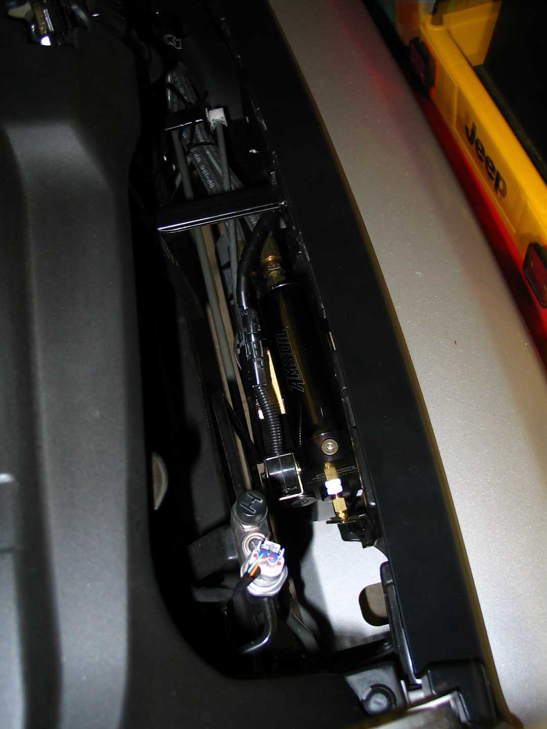

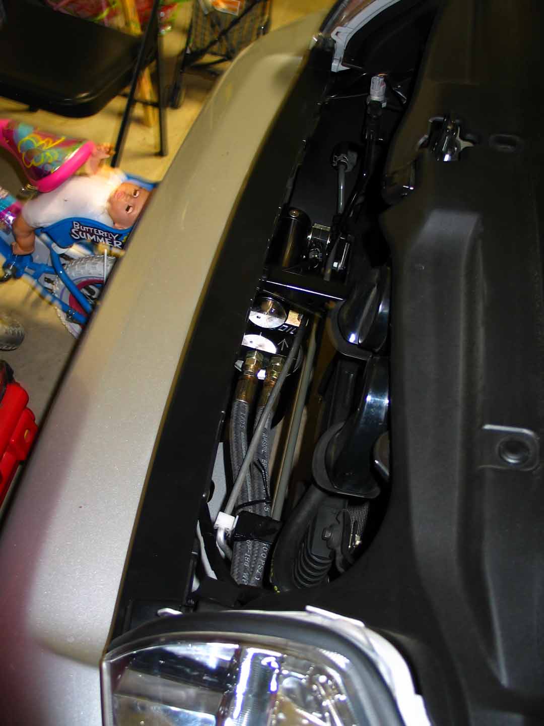

Sorry for the way the pics turned out. I'm new to photoshop and to posting pics. I hope these look better.
hope this looks better, more to come

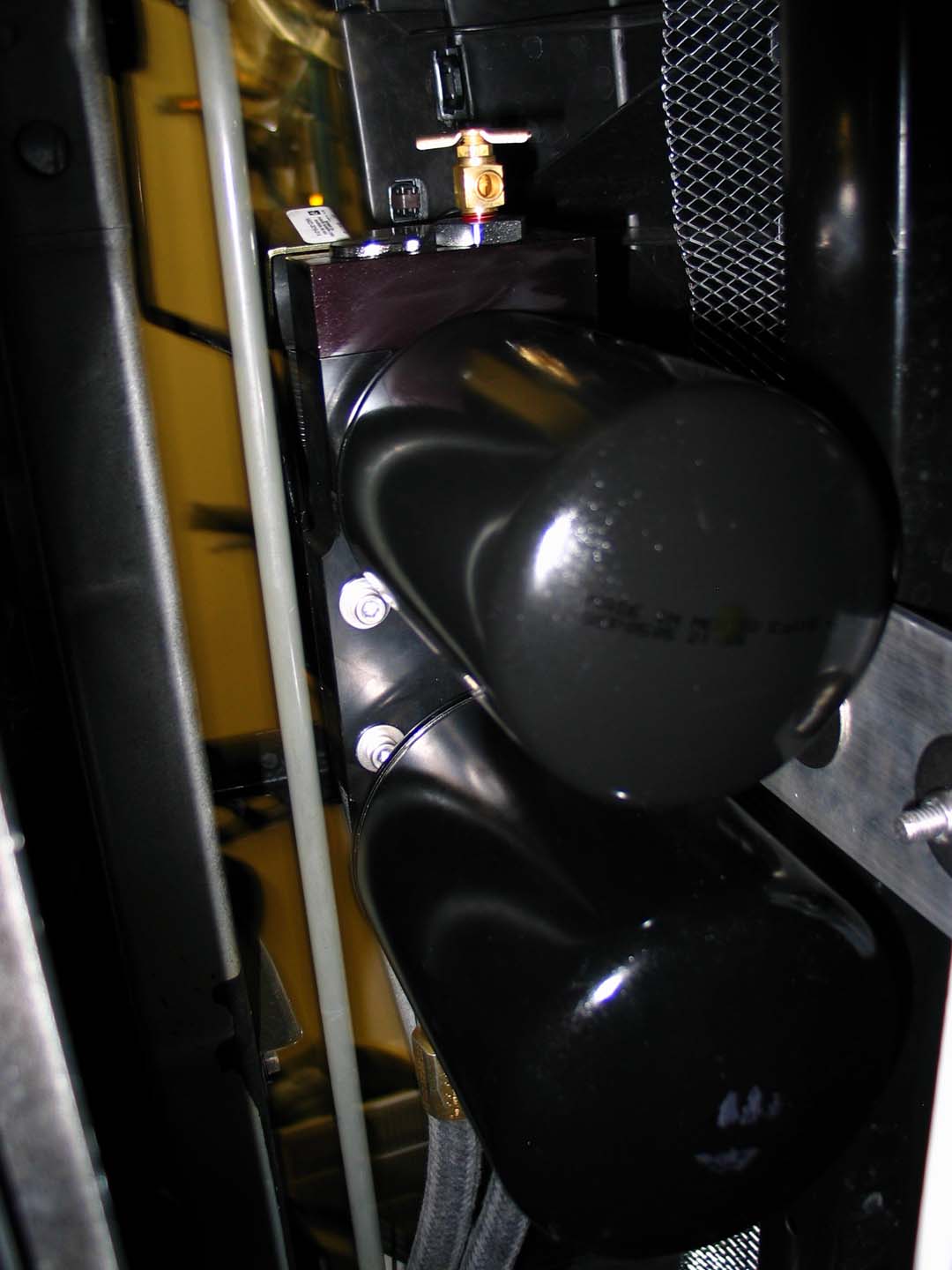

From the bottom. BTW, I'm using the new Ea full-flow filter. Superior filter, and also important -- it is black and will not show through as easily.

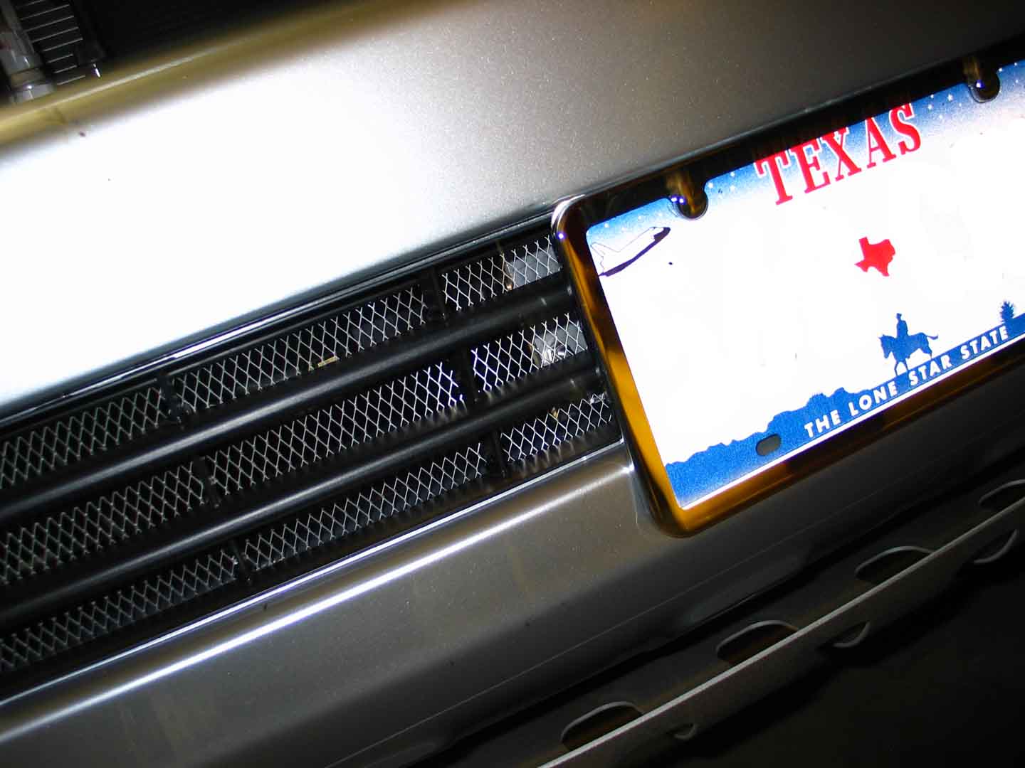

And, finally, from the front. As you can see, I've done the grill mod which does help. You truly cannot see it -- day or night -- and i've looked closely. I think this would be the case even with out the grill screen. I did peel off the label on the by-pass filter and the sticker on the Ea just happens to be facing away. Both of these help. I was worried initially, but am very happy with the result.

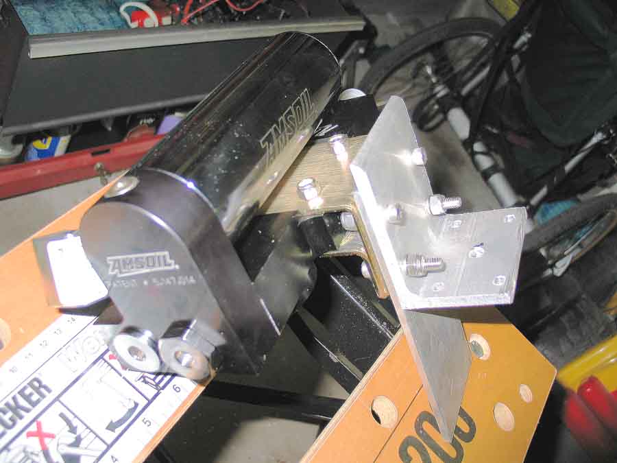

Amsoiler installed onto remote by-pass kit.
Can also see the xtra bracket I added.
