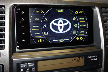

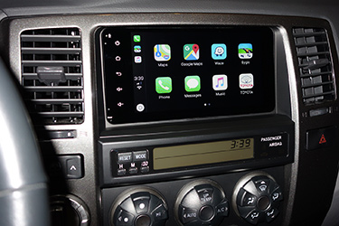

I have an 07 like you and made the swap from factory nav to Android head unit for many of the reasons you noted. Overall I really like the Apple CarPlay for Navigation which is significantly better than using the Factory Nav. I dont necessarily recommend the unit I have, but I am not removing it either. I think you can get some good install ideas from my page and see some of the issues i encountered as well as the add-ons I made too.
4th Gen Toyota 4Runner Android Head Unit
Question - is that Android Auto, relying on your phone being plugged in somewhere... or is it a head unit running Android?
More specifically, is it using your contacts, data, etc. from phone or does it not talk to your phone?
I ran an android HU for years and loved it. It was an older (now) Joying model and worked very well with only a few minor hiccups. I could never go back to a more "closed" unit again.
The first pic is an android car launcher app, AGAMA (not Android Auto) while the second pic is Apple CarPlay. As for Android Auto, it's enabled by the headunit but it uses the data (cellular, contacts, apps, etc.) of your phone.
If you have a basic, non-Android Auto enabled headunit, you can use a program called Headunit Reloaded to trick your phone into running Android Auto (works via usb, bt and wifi).
kaitlyn2004, the above is correct. I would just add that the CarPlay you see running on the Android headunit in the pic is powered by an add-on dongle that is plugged into the android headunit. The dongle can also display Android Auto if you are using an Android moblie phone, I dont have that so i didnt try that feature.
