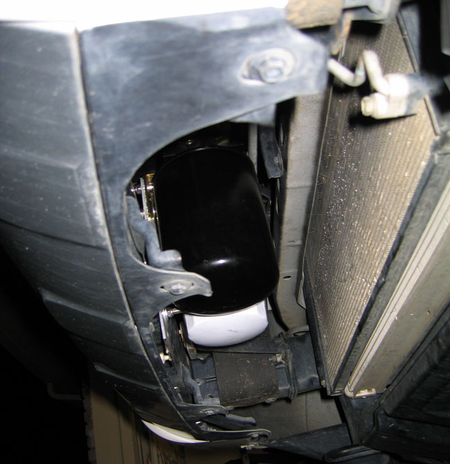

Couple of questions. Maybe I'm mistaken, but if you get into any kind of an impact that pushes back the front bumper aren't you going to crush the filters and lose your oil? Seems to me that you're going to be having to tow the 4R home from a lot of accidents that would have been driveable before. Not that any of us wants to think about getting in accidents. :eek:
How is the clearance for getting an oil filter wrench on the filters? Seems a bit tight, but again I haven't looked up under my bumper to see how much space there really is there.
BTW, nice job and interesting thread.
I would suspect that if the impact is enough to move the bumper back that far, the 4Runner had better be towed to a garage anyway.
Minor hits, where idiots park by sound, will have no negative effect on the relocated filter.
Room to remove the filters? I have rubber strap wrenches, so no problem. Much easier than the removal from next to the anti-roll bar behind the skid plate.
