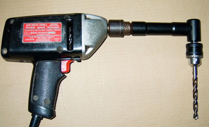

The installation placed the bypass on the backside of the front bumper, the same place Koz selected. I drilled two holes thru the bumper with a 90 degree pivot.

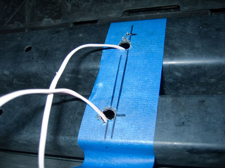

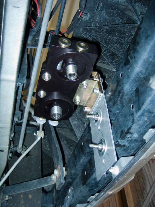

Here is the backside of the bumper. I used bell wire to snake bolts from the open end of the bumper frame.

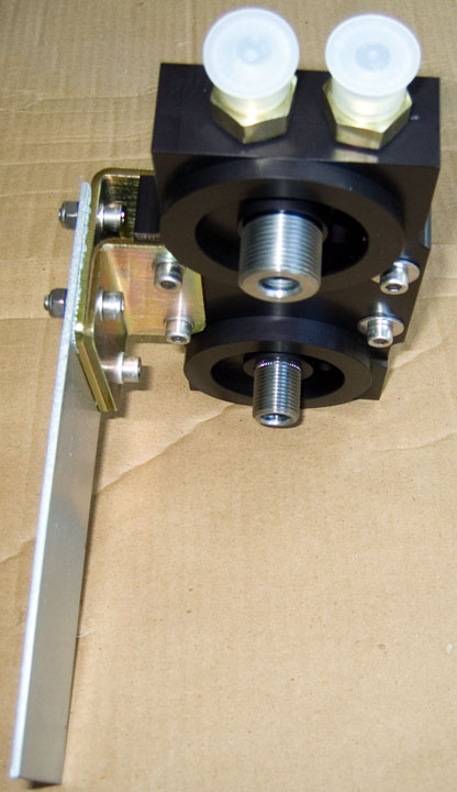

Here is the assembled bypass filter ready to install onto the bumper.
The kit installed is the Amsoil Dual Remote Oil Filtration System # BMK-13.
The kit includes Loctite 545 purple thread sealant. Maybe I used too much, but I wish Amsoil included twice the amount.
Kit Substitutions: I replaced all their SAE hardware with stainless steel metric hardware from my supply.
Additional Supplies: 1) 1.5-cm wide professional zip ties. 2) Self sealing and healing (no glue) tape to protect hose at all places where it touches the 4Runner. 3) Steel plate per the dimensions of Koz.

I applied 1 minute epoxy to the inside of the bumper to attach the bolts. This permitted to get the nuts started without the bolt turning. I then used vice-grips to hold the bolt while I tightened the nuts. I also applied more epoxy to the backside of this steel plate to secure it to the bumber frame.

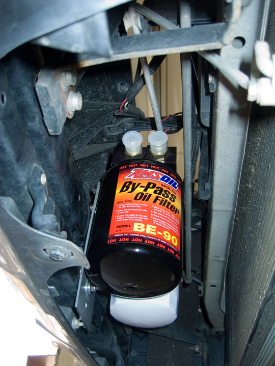

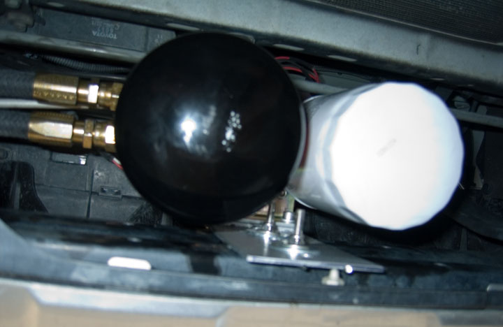

Here is what it looks like with the two filters. Using Koz's dimensions for the support steel, neither filter extends below the bumper frame, thus well protected.
As you can see I used the Amsoil BE-90 bypass filter. I included the Amsoil SDF15 oil filter.

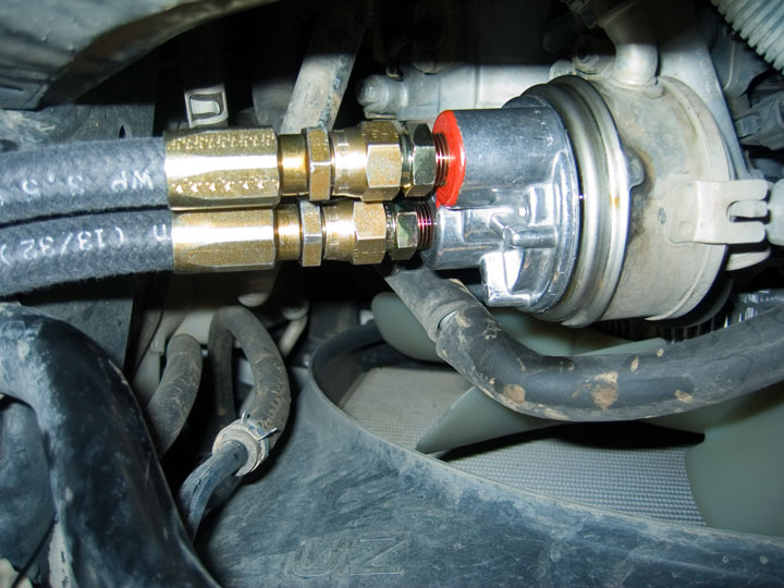

Here is the oil bypass installed onto the 4Runner oil filter location.
Here is what the fully installed bypass filters look like.
It took two gallons plus about a quart to get a full reading on the dip stick. WOW!! That is a lot of oil. I have the 2004 V8 4Runner.

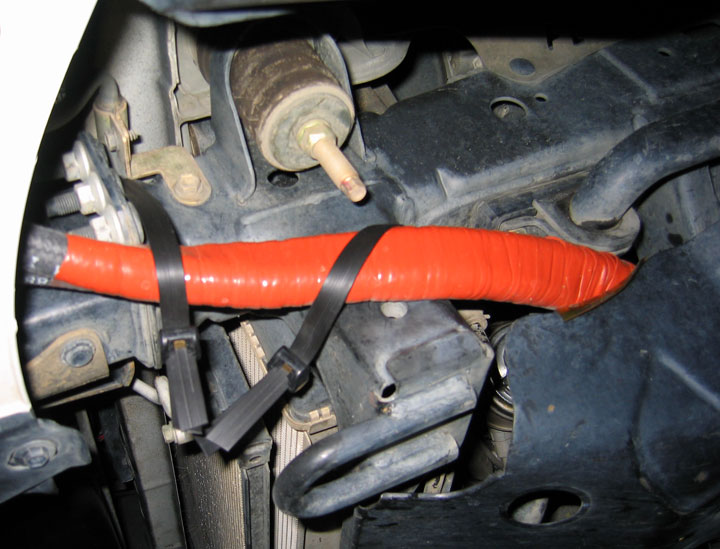

Looks like you really had fun with mounting the adapter plate. I took the easy way out with rivets. I can always unbolt the filter mount from the adapter if it needs to be removed. If you routed the hoses the same way as me, a small section is exposed in the wheel well. I recently covered that section with electrical wire-way (plastic spiral type, sold at any auto parts store. I'll post a pic as soon as I can.

This is the hose routing past the skidplate and around the frame to the front of the 4Runner. I added a split hose to the edge of the skidplate to protect the hoses.
