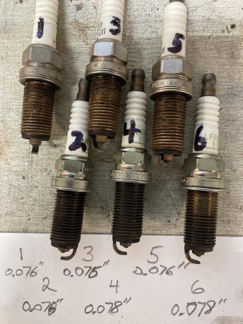

#6 looks fine. Id be concerned about #4. I havent seen a plug that bad in any toyota I have owned. Thats way too much carbon. I would seafoam the top end and add 1qt MMO to the oil on the next oil change to clean the piston rings. Change your pcv valve. It might be sucking in too much oil

Re-gap the plugs
I was supposed to leave on my road trip today but wanted to check a few things before I headed out with the truck. The pcv was changed in 2020 or about 36k miles ago. I only have 3100 miles on the current oil and was planning on changing it before going as I will be putting about 2500 to 3000 miles on it during my road trip. I have never used seafoam or MMO. I guess I could try both.

#6 piston crown and spark plug look suspiciously clean, usually caused by coolant ingestion. Steam is an excellent carbon remover.

This is how mine looked at 220,000 (orig plugs). Some are cleaner than others. Notice the gap sizes, and it still ran pretty good.
