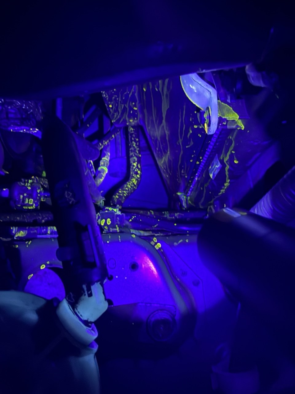

Had a rave in the engine bay this morning.
Stared at this for a half hour. Seemed almost like a radiator leak. Ended up following it to the upper rad hose where there was just the tiniest spot of coolant. Looks like it was coming from there and then running down and then getting blasted everywhere by the fan.
Found the hose clamp to be quite loose. Hopefully that is all it was! I checked my other hose clamps and a couple were a bit loose also. They were tight when I installed them so I probably need to make it a habit to re-tighten new hose clamps after a month or two of heat cycles.
Are you using worm gear clamps or hose clamps? I will say from experience that using worm gears for the cooling system is a bad idea. I recently did my head gaskets (@zguy1 has a fantastic reference guide) and didn't have hose clamps for the tiny hoses at the throttle body; 15 minutes test drive later some coolant was leaking out.
You previously mentioned having to tighten clamps after heat cycles, which is why I asked if you're using proper hose clamps or what sounds like worm gears. If the latter, there's little point troubleshooting until you put the proper part in place.
