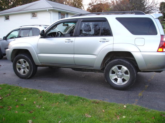

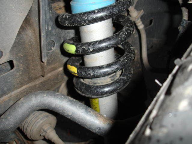

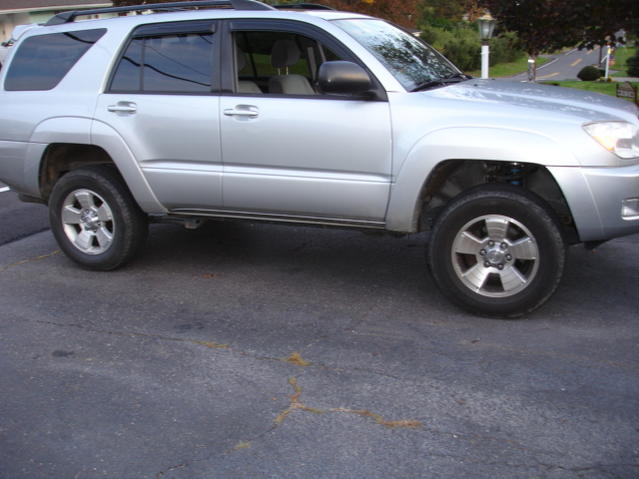

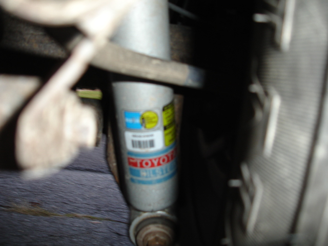

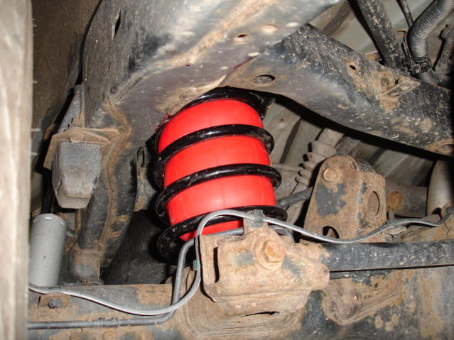

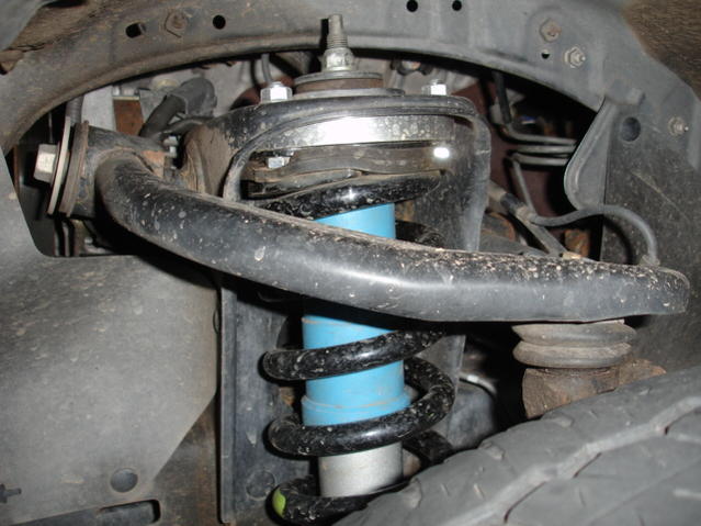

finally completed my fj conversion. here it is. fj trail teams bilsteins shocks / fj trail teams springs front and rear. 1" spacer in front. airlift aig bags in back. on order 265/70/17 hankook dynopro at. better be here tomorrow lol. everything was pretty easy. hardest part was getting the rear shock off (they were rusted). didnt want to cut them off. air bag were super easy about 1.0 hr. just ran 2 line back to the lower side part of the rear bumper. also upgraded my hitch a coupe weeks ago. put on a class 3 toyota hitch.
future plan- breather mod , sway bar bushing mod . cai (will be here friday). magnaflow exhaust. maybe a front winch bumper ( my buddy wants me to build one for his dodge and my runner , well see) plus more time will tell.

Welcome to the club:bigok: IMHO it's pretty special how much of an improvement it is for so little $$$.
It looks great!
:cheers:
true true. i dont have a ton of money into it and it just what i want. shocks & springs 70.00 , air bags 50.00. spacer 100.00. all you have to do is wait for the right deal on ebay and everything is cheap. and everything is new except for the shock but i was told there is less then a 1000 mikes on them. cant beat that.
front is just a tad under 2". the rear is around an 1". with the bags it varies. i dont know if the trail team springs are a little heavier. not sure. i really like the set up. for the price i cant go wrong. this will do for know. hopfully in the future i can get a different lift and bigger tire. i really want to run 33 on my 4runner. i have a set of front shocks with fj springs ready to install if your interested. you can find cheap rear springs on ebay or the fj forum. i look there all the time for stuff.

what is the air bag.
the reason why i ask is because i plan on doing the fj lift.
im buying the trd off road fj shocks but everything else confuses me.
They are made by Firestone or Airlift. They go inside the rear coils and use about 5psi-35psi of air to help level the vehicle when it's loaded (inside or with weight of a trailer). They don't function as a lifting devece but they do allow you to retain the 'unloaded' height even when loaded. I have them and love them. Link in sig. Here's anonther: http://www.toyota-4runner.org/showthread.php?t=53088
:cheers:
they are airlift 1000. part # 60809. average price around 80-90$ . i found mine on ebay for 50.00 new. have keep watching for the good deals. they are real easy to install when you do the swap. the only think i recommend in the install is run the valve up. air lift says to run it down ( i didnt like that idea). firestone bags say to run the line up. i really like this set up for now. handle real nice , not so bouncy on the highway. i would recommend this set up to any one.
do you benefit in any other way besides maintaining a lift at all times
I do... It depends on your install. If you use separate right and left fill valves it handles better in normal driving. (I run 15psi in the left and 10-12 in the right.) It helps to reduce bodyroll.
If you use a single fill there's no benefit beyond levelling that I can think of besides one more item for you signature line at T4R.org:D
