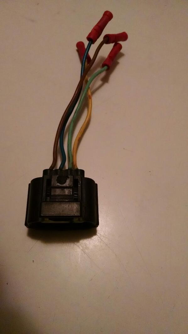

I made this after a visit to the local LKQ. The crimp on butt connectors are crimped just enough on the open end to hold my multi meter probes nicely.
I adjusted the TPS properly. I was having trouble keeping the probes in good contact in the very cold weather here. I then broke out my 1973 vintage timing light and "discovered" someone had set the timing at 18 degrees or more BTDC. After I put it at the specified 10 degrees, it runs way better and closer to reality. It will get a couple days of test driving to see if it needs further help.

Did adjusting the TPS cure the high idle? Mine does the same thing and adjusting that is one of the many things on the to-do list
Between adjusting the TPS and setting the timing, major improvement occurred. It's still surging after coming off the expressway when I shift to Park when I get to work. I need to check the fuel pressure due to possible clogged fuel filter issues. See my previous thread on what we found and running on 3 cylinders.
