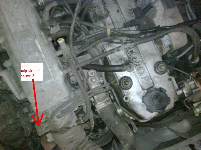

Is this the correct screw?
Nope, your idle adjustment screw is in a boss on the throttle body. I can't tell you exactly where from memory but it will be below that screw and on the other side of the TB. I'm thinking that it is not your problem though, if your temp sender is not working correctly your ECU thinks the engine is cold all the time so it is running on fast idle constantly. At least that is my thought at the moment...

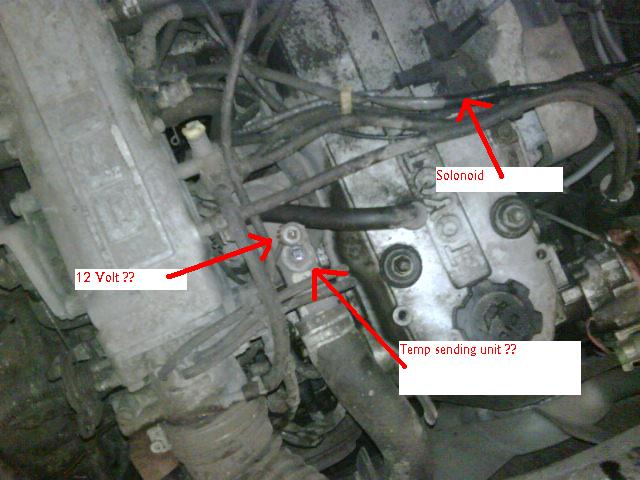

As to the temp sending unit, is this it?
The idle problem slowly creeped up. Was not an issue before last summer.
I have not changed out the sending unit and it has not been properly connected for as long as I have owned it. ( see the other post about the sending unit )

Hehe, ok. What I think is going to help you the most is a Toyota Factory Service Manual. You can download what you need from here Toyota Tacoma/ 4Runner/ Tundra/ FJ Cruiser Factory Service Manual Page
It looks like you are going to need to test your sending unit per the FSM, it also has a troubleshooting section that will help you dial in where the problem lies if it is not at the sender.. It sounds like you have a multimeter and know how to use it, so now all you need are the resistance values for the sensor(s) and you are set.
