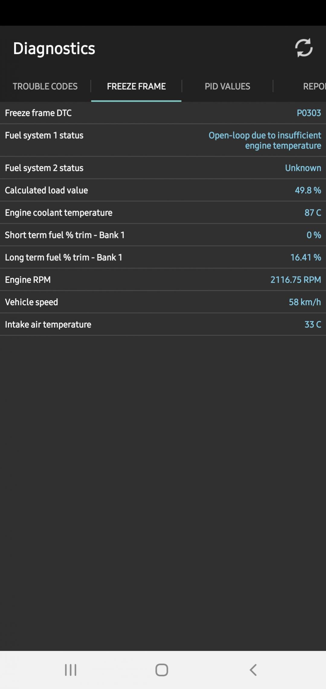

It looks like you have freeze frame for p0303 what does that look like? Cylinder 3 and 6 are companion cylinders so possibility of being a coil. Wondering why you now have a p0172 instead of the p0171.
Swap a coil. Clear all codes and see if the cylinder faults move with the coil.
Sent from my SM-J337V using Tapatalk
That last Screenshot was right after doing the seafoam. I thought that was why it was reading too rich. I'll pull the freeze frame tomorrow when I drive to work and post it here.

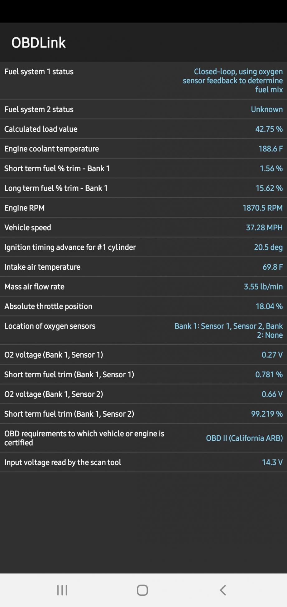

Coolant is good, no bubbling or excess in overflow, no white smoke at all, not even after seafoam, and it seems like its not a constant misfire. I can turn the runner on and know right away if it's running rough or not. If I turn it on and its a smooth idle then it will stay like that for the whole trip, mind you I haven't been taking trips more then a few miles at a time so it could start to misfire if I drove it for longer. Here's the rest if the info my OBD reader shows while its misfiring. This data was taken after the truck had been on and running for only a few minutes. I work 5 minutes away from my house so I wasn't able to get a good run this morning.
