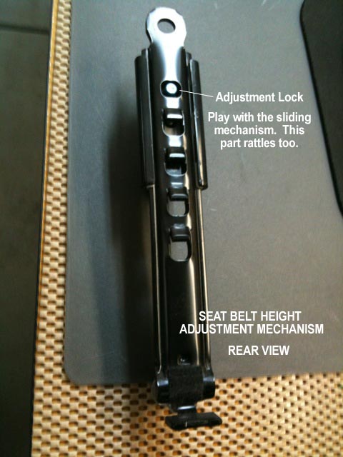

T4R 2004. I have this rattle noise ever since. Dealer not able to identify. I have this thuck for 7 years, except for that rattle, I love it. The noise usually surface during winter. So, far I did all what were discussed in the forum. Last week I even dismantled the pillar cover, removed seat belt assembly, fixed it on topmost height, padded with rubber and taped the sliding bar. Reassembled. Rattle still there. This morning, I taped the crossbars on the roofrack because it rattle when I pound it. Test run. Rattle still there. Previous things I did; lined the backseat locking "D" catch with electrical tape, taped weatherstips that were loose, put gum tape inside the door trim, etc. Nothing solved the rattling noise. Were you able to solve it?

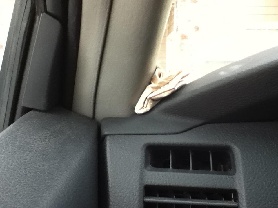

I took a picture of my short term solution on my iphone, let me upload it tonight. I basically shoved a folded napkin between the dash and the pillar and that seemed to help dramatcially. About a week later, the noise came back. I pulled out the bapkin and noticed it wasnt lodged in there as good as it was before. How did you take apart the pillar? Do you have a manual/guide? I've been meaning to get in there and maybe put some foam in it or something...

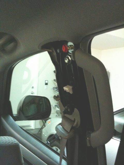

Your fix was on the front pillar. Mine was on the mid-section. Anyway, just in case you or others may like to find out. I removed the pillar cover doing the ff:
1. Snap-off front and rear door sills.
2. Remove Seat belt anchor (bottom of the pillar)
3. Snap-off the lower cover (need to pry off from the sides
4. Remove 2 screws that hold the top cover
5. Pry off the sides and slide the top cover down

Here's my short term solution as described above...
