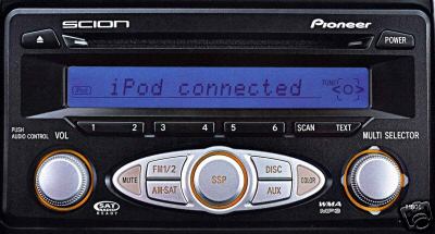

........ The Scion 2006 Ipod HU (the one with three knobs) is a little trickier I believe. ............
3 knob T-1806 head unit is a snap to install and 100% compatible. Here is a picture

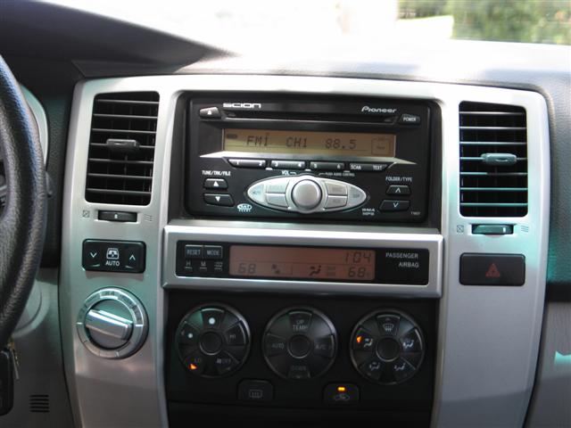

Here's a pic of the 1 knob '06 Scion h/u (T1807) in an '05 SR5. This fits perfectly and looks great, very stock in appearance. Trying to remove Scion logo looks like it would do some damage to the plastic. I don't mind the logo, especially since you can program the display to show '4RUNNER' when you start up. One thing to remember is to bend or cut away the small metal plate above the antenna jeck. This will expose a second jack that is not used in the Scion, but is used in the 4Runner.

Falls, the switch was definately worth it for sound quality. The Scion is much better than the stock h/u. Plus the price is right, about $100 inc. shipping off E-Bay. Crankability is not exceptional. I'd guess these are only 20 to 30 watts per ch. I upgraded speakers at the same time & could really benefit from an external amp. Maybe after new tires and shocks... One of the things I really like is the ability to play MP3 or WMA cds. I burned a mix disk of WMA files and was able to put over 100 songs on it. Just put that on, hit random play and your good for almost 7 hrs. To me that beats a 6-disk changer all hollow. :p
