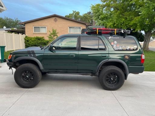

I currently have Kings in the front at the height they came at and then 890's in the rear. I have a 4x Innovations rear swingout with spare tire, rotopax mount, and Hi-Lift jack. Also have a RTT. When it's loaded with camping gear there is some slight sag so i'll probably put on the C59-210V springs I have soon to give me some more height. **Rear Coil Spring Discussion - The Perfect 3rd Gen Rear Spring** This is a good thread to dig through also to see what others are running for springs.
