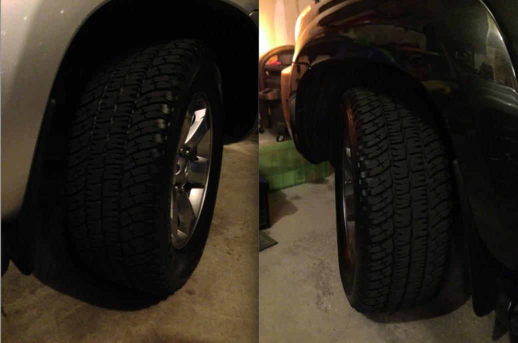

My vote
Mostly in my last truck (in sig), I've driven in OK during the winter with the LTX M&Ss and they did fine. I was there during a snowstorm once and thought it sort of funny that the locals were going in the ditch while the AZ driver stayed on course with no issues!
That being said, I just got new tires: Cooper AT3s. I would have liked to get the M&Ss, but I only drive about 5-6000 a year and they would have dry rotted long before I got to the 70K mark. So far the AT3s have shown to be very smooth and very little road noise...and I saved $250, too. The only downside so far has be loss of mpg. OK...I did get them for looks as well.
