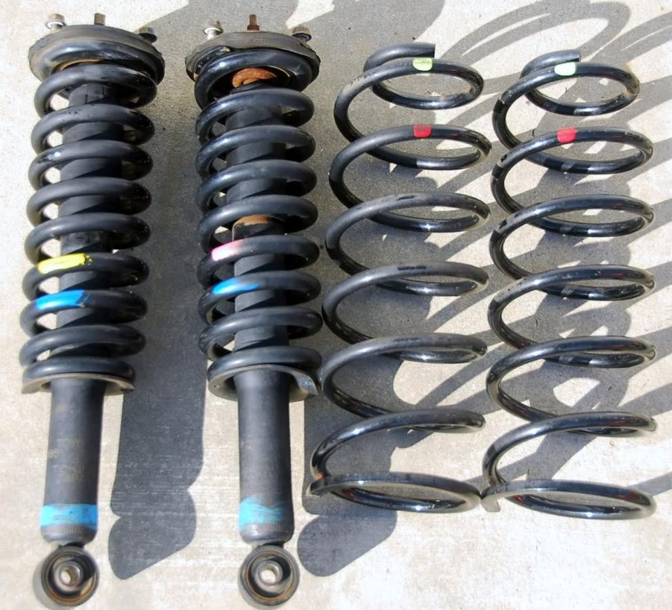

Sorry to ask this, but I have searched the forums for an hour with no luck. One of our members is looking to do a low bugdet lift. I would like to sell him my springs from my '99 SR5, but I want to make sure I'm not ripping him off.
The fronts are the correct number of wraps and color coding (9 wraps, yellow/blue and blue/pink). My question is about the rears. I'm assuming since I have the tall fronts, the rears should be, too. They have the yellowish/green and red markings. Does anyone know if there were different rear springs on the '99. Thanks.

Different from what? You DO have the taller '99 rears and they also had shorter ones, generally on trucks with 15" wheels from the factory.
I do have the 16" wheels. I just want to be sure. He has already purchased a set that were claimed to be "talls", only to find out they were not. I don't want to be the second person to screw him. :ybrick:
I just bought a set of the same color coded 99 talls as you outlined in the OP from another member on here, so i'd say I agree with the Durk, you have the talls.
These aren't mine, but a pic that another member posted that I saved:
