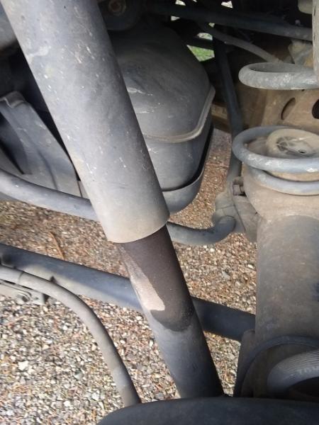

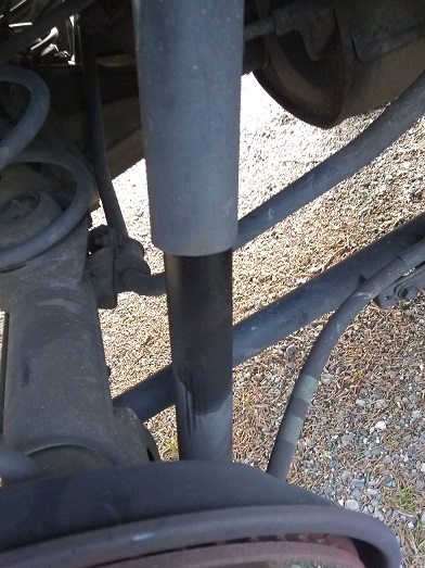

1. Once I removed the wheels it was obvious that 3 of the shocks had been leaking slowly (discolored dirt). Enough fluid had leaked out allowing the rear to bounce off the stops when driving over speed bumps. Due to this fact, I disconnected the XREAS shocks at the their banjo bolts. It didn't make a big mess as I just put a catch pan underneath. Yes, there are check valves, the rear play hard to get.

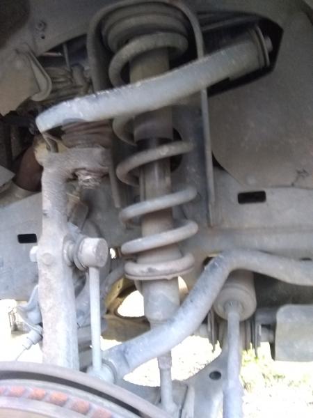

5. I was going to take pictures, but I got frustrated so I'll have to console you with pictures of the failed XREAS shocks.

Man, yours look 3x better than my set of XREAS at 185k.. mine have rust that have corroded the actual shock body..
Still ride decently though with the metal tech conversion for the rear airbags.. time will tell.
