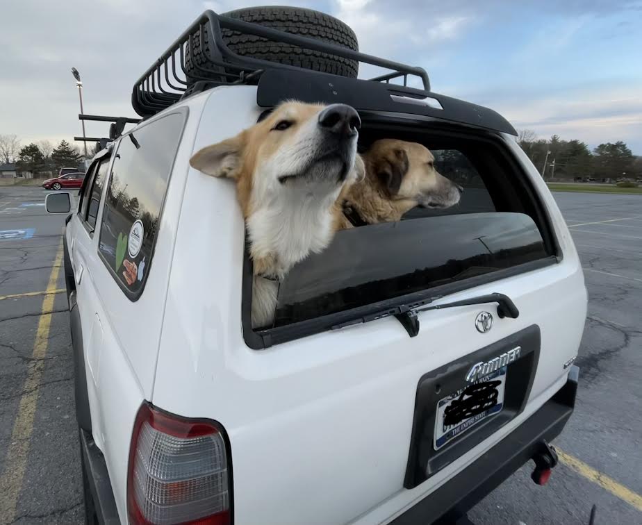

Super cute pups :love:

Oh, the pups say thanks! They were SOOOO happy to have their back window again, life squished into an Outback all winter is just NOT as fun as slobering all over the outside of dads tailgate....
