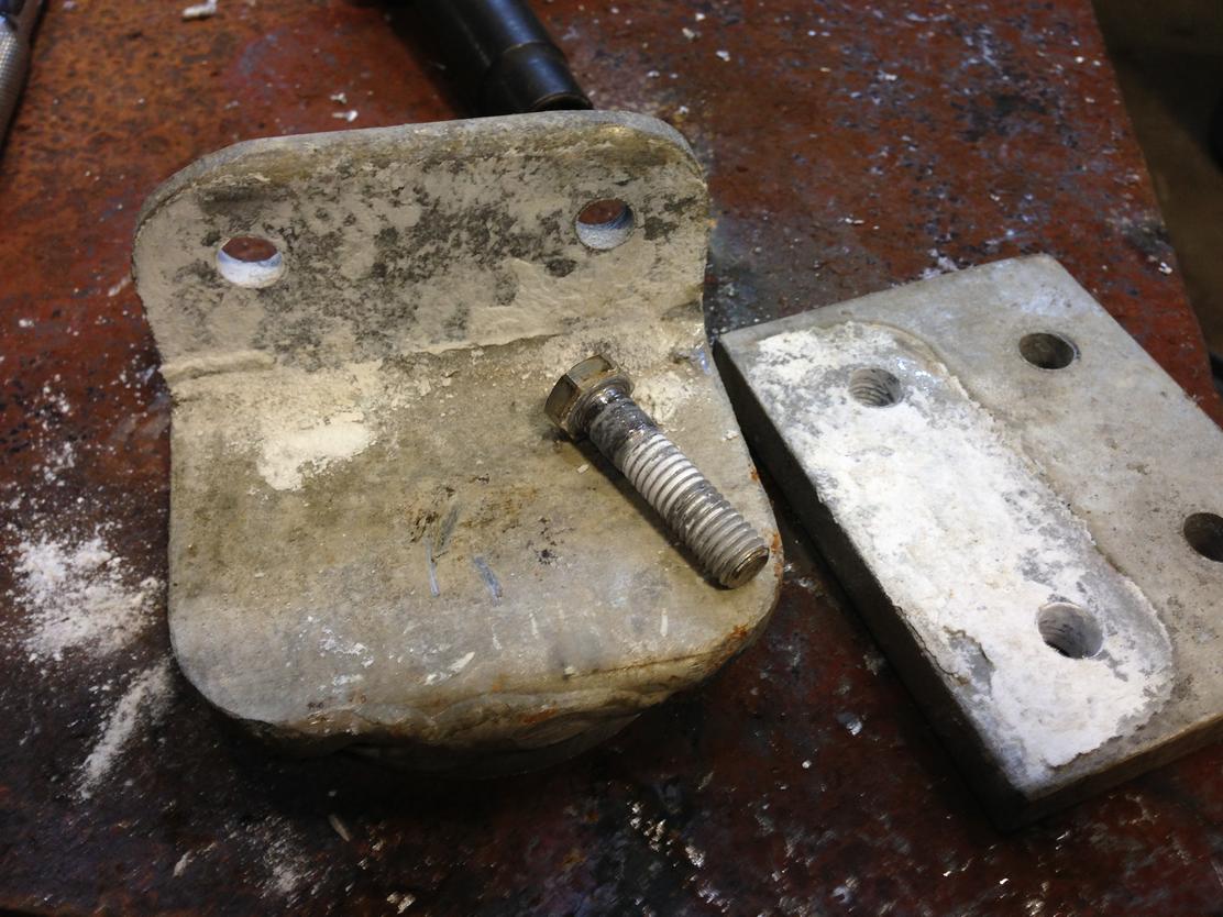

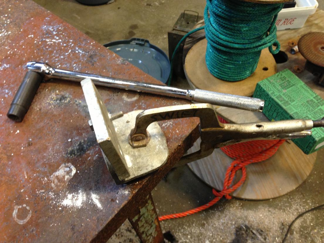

Aluminum and stainless do not mix well in a marine environment. probably fine in arizona or texas but anywhere there is salt on the roads i would think this is a possibility. I saw some newer 2005-ish vehicles in newyork,illinios and michigan that had their fenderwells rusted out. The roads there are worse than anything i have seen in coastal alaska and left a layer of salt on my 4runner after just several hours of driving.

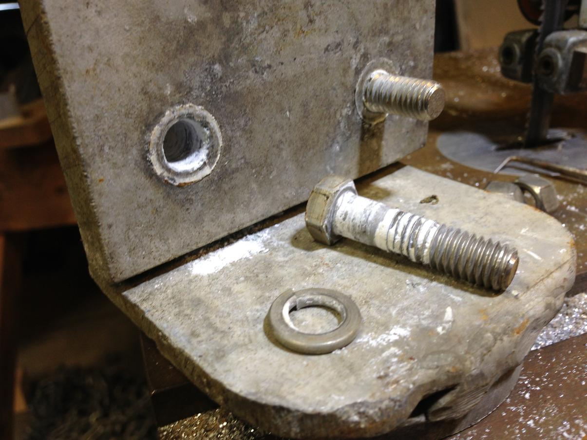

Heres some 3/8 aluminum plate , thru-bolted with 3/8 s.s. fasteners the white powder is corrosion ,salt ,corroded aluminum. I had to use a 1/2 inch breaker bar to get the bolts turning. not so bad on 3/8 and up fasteners but if these were 1/4 inch bolts they would be snapping
so always use some form of anti-seize ,even normal clear silicon sealent has worked well for us on aluminum and stainless. my personal preference is the lanocoat brand as it is not messy (no silver fingers) but the machinist down the street prefers a blue moly anti-seize so go figure.
