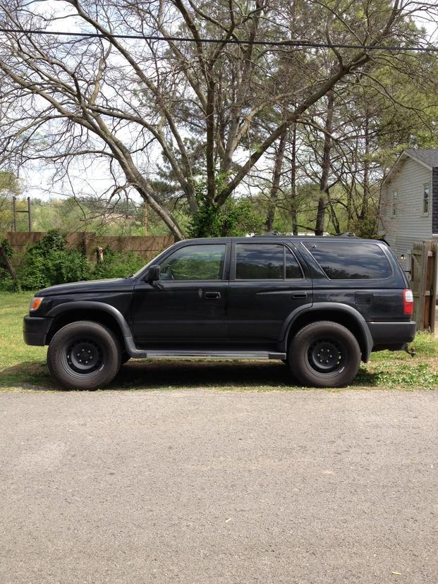

I think I've got a case of the SAGS, sagging rear end
I apologize in advance for the puns but...
What do you guys think of my rear end?
I've seen a few other Black Rippers (4Runners) around town and notice they have a stronger, more healthy looking stance to them. There is no extra weight in the vehicle in this picture, but I've used this beast to haul music equipment for years.
I'm doing a few things to the front to help with stability (upgrade sway bars, new lower control arms) but I'm wondering if the next item of attention will be shocks/suspension and struts.
Any advice or links would be greatly appreciated.
Thanks team.
