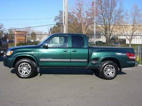

The rims are from an 03 Tundra Stepside, tires are 265/70/17 BF Goodrich All Terrains.
Here's a stepside so you can get an idea:

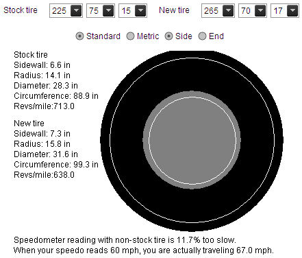

stock suspension, no lift. The tires are 1" over stock for the Limited model, 3.3" over stock for base model.
here's the difference between stock and what I have:
thanks, must be tricky with the speedometer haha when it reade 60, your goin 67. i would get pulled over alot until i got used to that

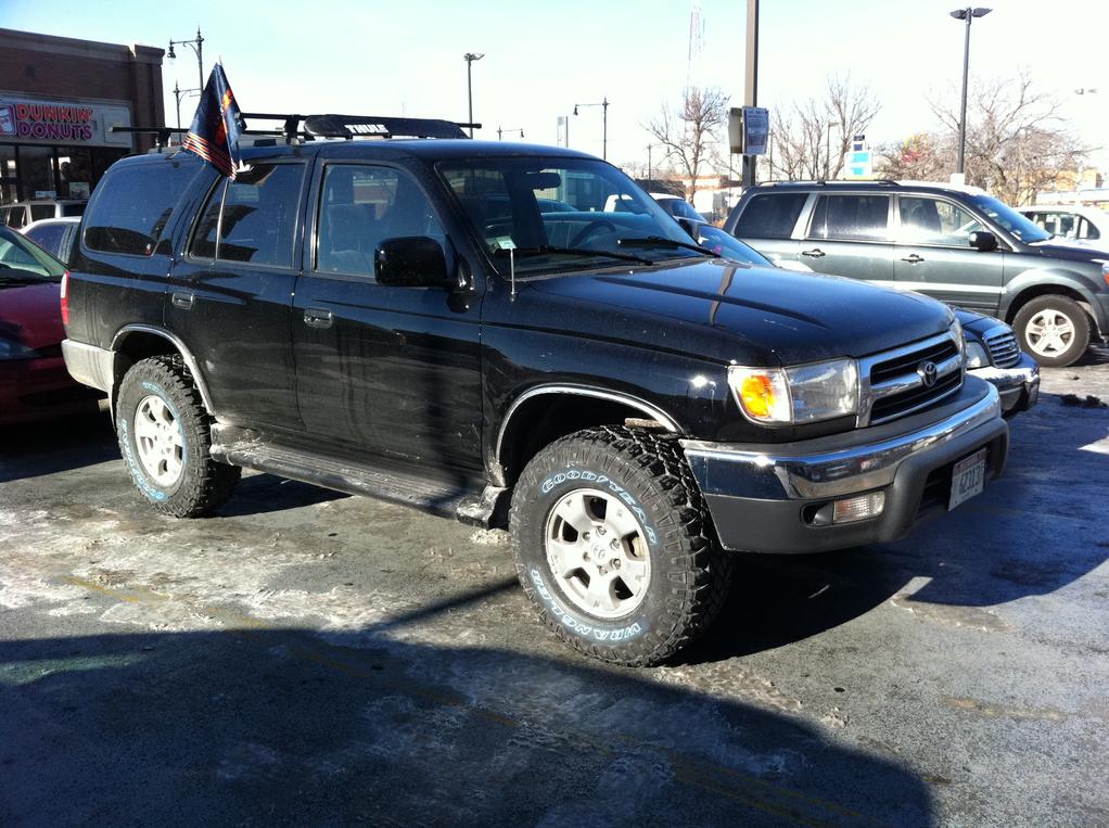

Base T4R 4WD
Building up my base. Found skid rails but are to short. I guess off of a 95'?
I have a Thule on factory rails for now. Looking for OEM skid rails WTB.

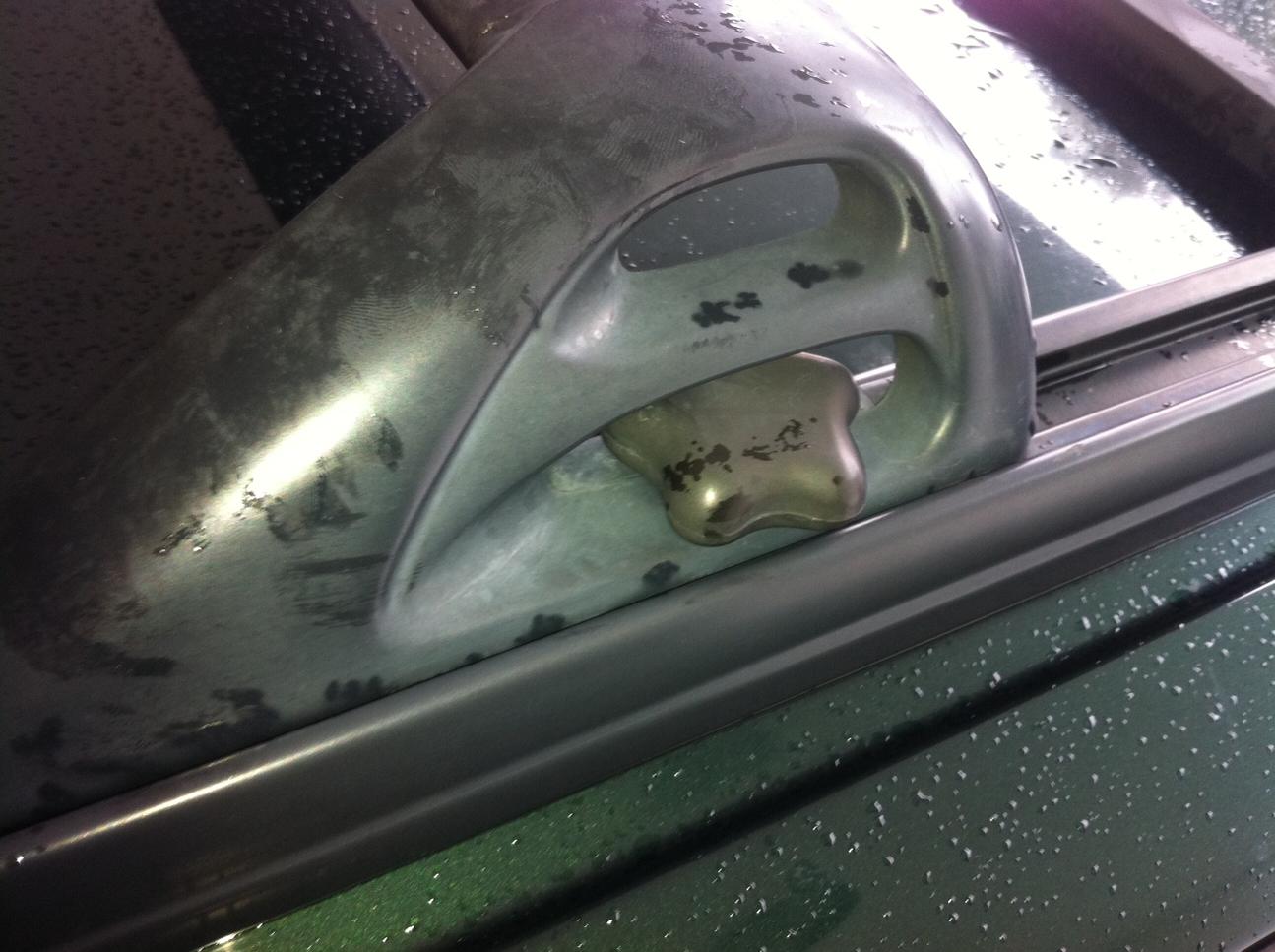

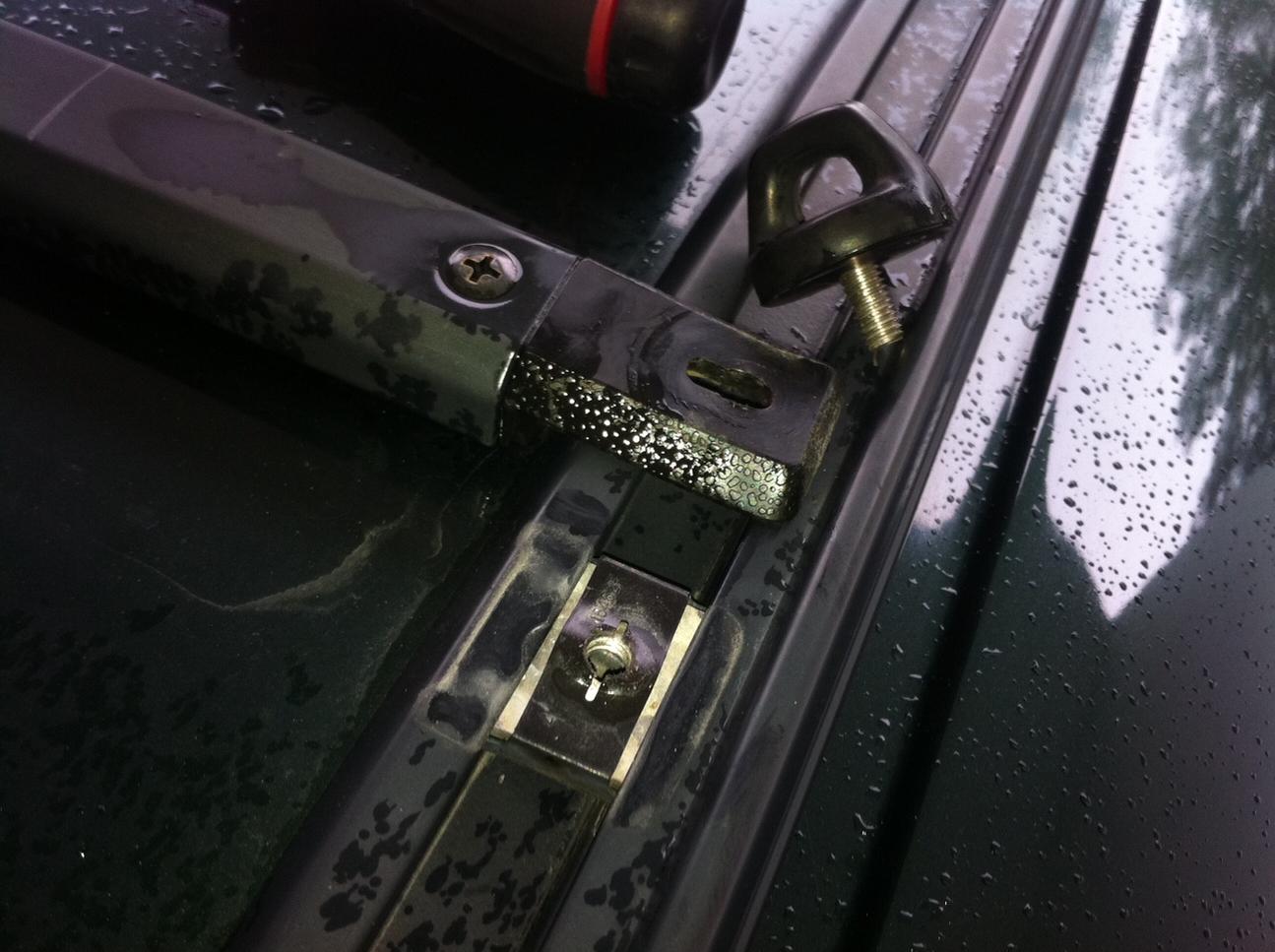

Mounting OEM Crossbars
So, I am piecing together factory roof rack set from various places.
I have OEM rails, Crossbars, thumb wheels and eyelets. The cross skid rails seem to be 1'' short. (I think they are from an earlier model T4R).
I removed end caps on rails to install but don't see how to attach thumb wheels and eyelets.
Do I pull Thorax screws and screw thumb wheels in those rivets? (I dont think so.)
Is there nuts that should come with thumb wheels and eyelet bolts that slide in rail groves to tighten?
Any pics or install diagram would be appreciated.

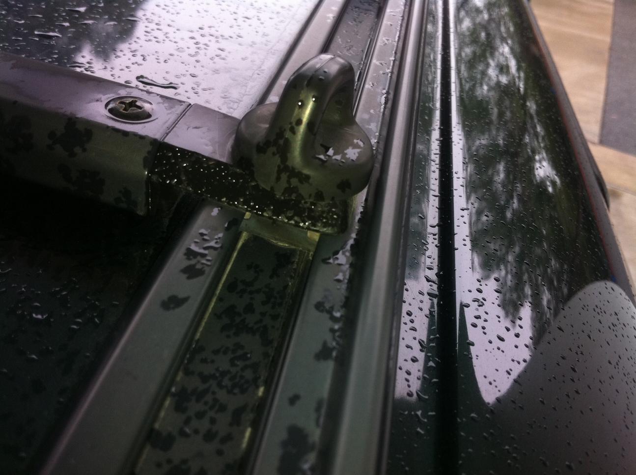

Each skid strip (rail) should have 3 sliders in them to mount the 3 additional crossbars. The eyelets screw into those sliders.
The two main crossbars have holes in them to tighten, they just slide into the rail and insert the thumbwheel into the provided hole and tighten. All Torx screws should be left in place.
If this is not what you have, I believe you may have incorrect parts.

Ya, I need sliders that are not in my rails. If you have a part # for sliders that would be great.
here is mine!!!!!!!!!!!!
<a href="http://www.flickr.com/photos/17507463@N04/5272827718/" title="DSC_0092 by Risen Origin, on Flickr"><img src="http://farm6.static.flickr.com/5283/5272827718_d812ca20ae.jpg" width="500" height="332" alt="DSC_0092" /></a>
There is no part number. They're built into the strip. I bought mine from the dealer (discontinued now) and they came with both the end caps and sliders which only come with the entire strip.
You have to find them either another way or get a new set of strips.
