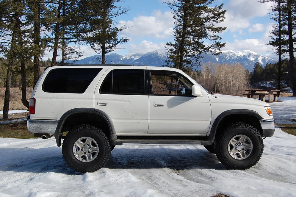

My 4Runner is my DD so it needs to perform on the street as well as the trail and I know my trucks limits on the trail and am happy with what it's capablities are so I've been hesitant to put a real lift on my truck but I'm fortunate I have the taller OEM coils and the +1 tires really help. Sliders coming soon.
I plan on buying a more sensible cheap car for the street and then maybe I'll sacrifice it's street performance.
These pics seem to make it taller than it is but I do have about 36" at each corner from gound to wheel well lip.
