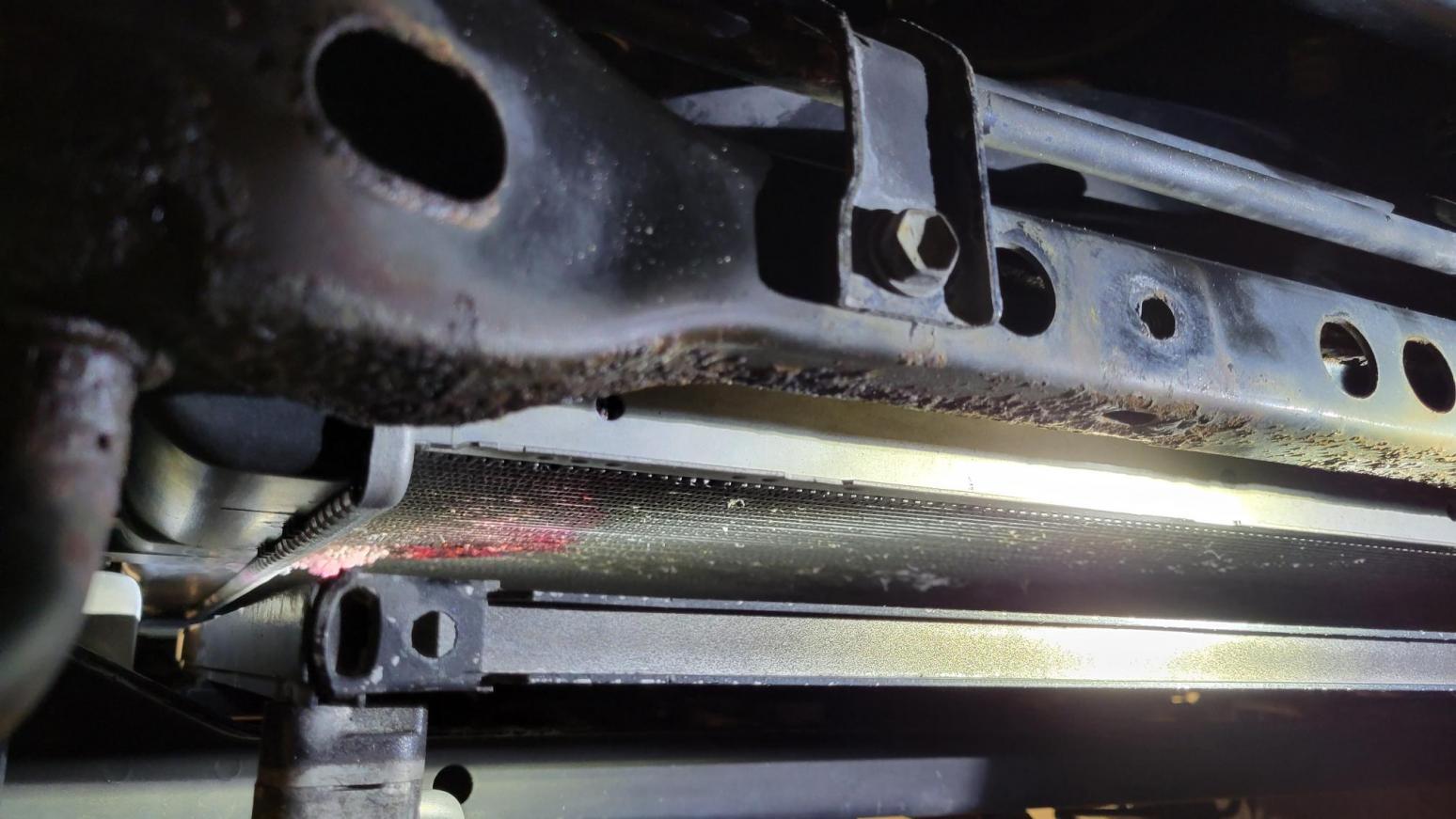

I recently discovered that my radiator is leaking. (See pic)
My 4Runner is 4.0 V6 with about 160k miles on it.
The leak isn't too bad. I noticed a few drops of pink liquid in the garage and started investigating. Overflow reservoir was still between low and high level. And it seems to drip only when pressurized. So I have some time to plan things out and gather parts.
