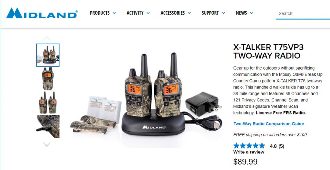

I had good results with a pair of handheld Family Radios. I used mine on sand dunes where the lead is not visible and on the Freeway. Won't get long range like the ad says, but good for 1/2 to 1 mile.
Depends on what your group is using.
Something like this:
I had a similar set a while back. Problem is there was only 2 radios and most people were using cb's. The range was limited. Most of the times here in the desert on higher speed fire roads you have to stay back a long ways just to let some of the dust clear out and they would not work especially in hilly terrain. Even though cb's are obsolete they are still cheap and work good.
Yeah I have a 4 of those as well. I use them for fishing and/or hunting in groups mostly. Seems like most of the organized trial rides use CBs.
