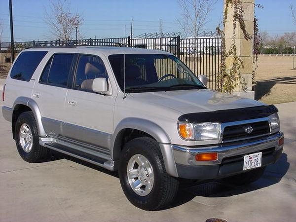

Fellas, I've had my 97 Limited for about six months now. I love her to death but I'm getting beat up with the cooky ride I get on the bad Oklahoma rodes I have to drive on. I'm looking for a smoother ride. My lil' b*tch will hardly ever get off road unless I'm lucky. But I also want to add a brush guard on the front and I've read on Yota that you should go with a heavier duty shock on the front end if you do that....?

Nice truck it really looks good. You may want to add clear signal lights in the bumber. I changed mine and it makes the front end look more updated. Run about $50 for the set at burtmanindustries.com. I have not heard about upgrading the shocks due to a brush guard.
