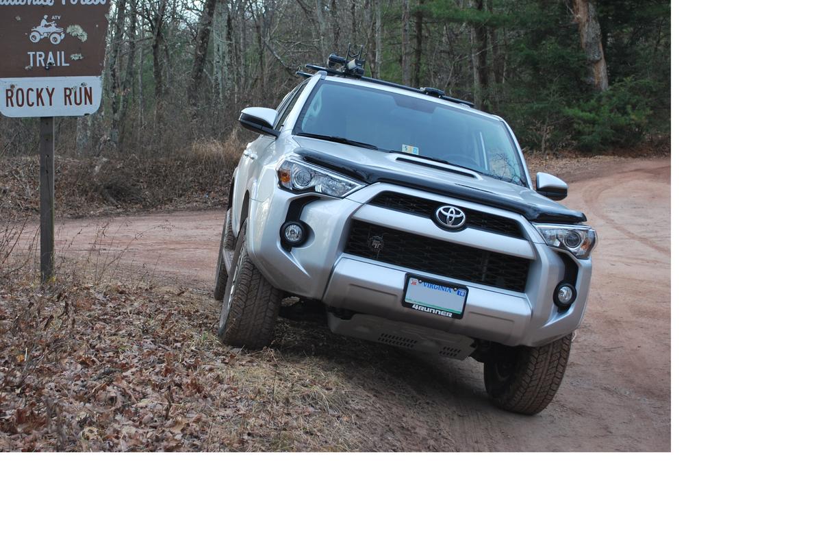

T4R badge is installed!! :party:
I put some lock tite on the brass threads so they don't get loose. I even had the chance to use my teeny tiny wrench.

The badge (and the 4runner) out in Washington National Forest (Virginia) :o)
