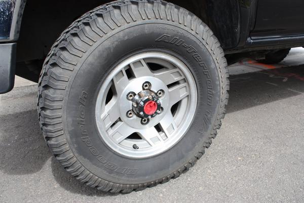

I loved the manual hubs in my 93 pickup! I can never understand why people made a big deal about them. If the weather may be bad that day, or you are going off roading, and you don't what to get out of your car to switch between 2 and 4wd, just keep them locked. Keep them unlocked for everything else. Plus, it was kind of fun putting it in 4low with the hubs unlocked :)
Also, after 163k miles without any service, they still worked flawlessly!

Probley the coldest it gets here is in the mid 20's during the extreme winters, and we had a week long snow storm where I never bothered unlocking the hubs. Honestly, I can't remember how often I used 4WD during my ownership, but ballpark maybe 50.
When I owned the pickup, I had yet to be enlightened by the Opti-Coat Gods, however I am sure my hub's paint would have looked a little better, and there wouldn't have been a spec of rust anywhere! Despite it being opti-coat free, it still looked pretty good!
93 Toyota Pickup Photos by amccaulx | Photobucket
I wasn't the original owner, so the PO could have greased the hubs, or had wheel bearing or CV issues, but I don't think they did from what I saw. I don't think they would have greased the hubs and neglected the more common services that they did. The only problem I had on that pickup was a blown HG on the 22re.
